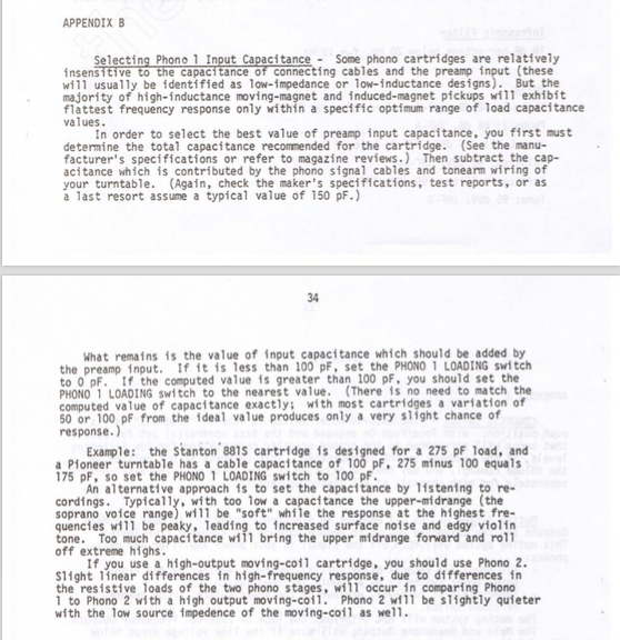

stevenlevel 146 Posted February 16, 2017 Share Posted February 16, 2017 I'm using a Technics SL-Q3 with my Carver C-1 mm phono stage. Does anyone know the proper pf setting I should use on the back of the C-1? I have it at 300pf right now and it sounds pretty good. I got that setting from a online post so I have no clue if that information is accurate or not. Thanks, Steve Link to comment Share on other sites More sharing options...
loner_t 2,568 Posted February 16, 2017 Share Posted February 16, 2017 Does the following extract from the C1 manual (Page 33) help? 1 Link to comment Share on other sites More sharing options...
kve777 6,674 Posted February 17, 2017 Share Posted February 17, 2017 Due to a lack of published specs, I set to the middle, listen to DSOTM, if it sound right I leave it, if not I try the other setting and use the one that sounds the best. It's a good idea to write down the cartridge/arm/cables/setting for each change, so you can go back faster in a swap, and have a good starting place on the next unknown. 1 Link to comment Share on other sites More sharing options...

stevenlevel 146 Posted February 19, 2017 Author Share Posted February 19, 2017 Dark Side of the Moon. Thanks I just didn't see that But I have both the vinyl and CD versions of that excellent recording I have two questions: In my Shure M97xE cartridge instructions it states "Optimum Load" including tonearm and amplifier input capacitance 47 k-ohms 200 to 300 pf per channel 1:So is 300 pf the proper setting on my C-1? I have it set there now and have been doing some vinyl listening tests but I have not played DSOTM which should allow me to get it right. 2: Has anyone used the KLH 7000A or the SAE 5000A with their Carver preamp and turntable? I had a SAE 5000 back in 1980 but sold it in 1985 when I bought my first CD player. I gave up on vinyl after 75% of my records were badly warped when I moved and didn't get the records out of my car before it was 95 degree's and 1:00 PM. So I ended up selling my old Tech SL-Q303 table, the Shure M97 cartridge and my SAE 5000 and about 75 records for almost nothing. I love vinyl again and have learned to keep it nice and clean but I have a few that still have the ocational annoying pop or click and wanted to know if anyone ever used one of these? Which is better? Do they affect the playback sound in a negative way? Sorry more than 2 questions. Thanks, Steve Link to comment Share on other sites More sharing options...
UncleMeat 1,173 Posted February 19, 2017 Share Posted February 19, 2017 No, 300pF is almost always too high, use the 0pF or 180pF setting. Try 180, then switch to 0. If the sound improves then leave it at 0. Usually if the cartridge is over-loaded it will sound muddy. 1 Link to comment Share on other sites More sharing options...

stevenlevel 146 Posted February 20, 2017 Author Share Posted February 20, 2017 Yeah, I just realized that having the .flac CD version is pretty meaningless when setting up vinyl Upon further review "The call stands" for either 0 pf or 150 pf which is what you and a few others stated would be the best setting. 300 pf is too high I have a Disk Washer that I use with 91% rubbing alcohol if a record needs to be really cleaned. I don't use rubbing alcohol very often, but some new records need it to get rid of any residue from the stamping. Now I have read about using dish soap and filtered water, but it's so hard to do without a real record cleaner that will hold the record properly. Any advice is very welcomed Link to comment Share on other sites More sharing options...
RodH 4,820 Posted February 20, 2017 Share Posted February 20, 2017 As for the capacitance loading you need to consider the cables between the cart and the preamp. These can often add upwards of 80-100pF on their own. Start at the lowest available preamp setting and give it a listen, then up the setting. Go with what sounds best (to you) not an arbitrary number and you should be happy. 1 Link to comment Share on other sites More sharing options...
