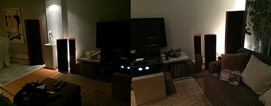

  1. Adjusting the speaker placement is difficult because of where the rest of the system and TV are located. The room is also small (20x17) for the speaker size - so I plan to test with different power levels (thanks LT) this afternoon.
  2. Thanks Kevin and LT- Re-positioning and re-angling the 9 kappas with 10-12 feet of separation did not provide a lot of improvement over the sound stage coming from my re-capped Infinity Kappa 6.1 - the acoustics from the 9s are beautiful . . . but, no improvement with the sound stage. A-B testing with easy system 1 / system 2 switching reveal a major difference in the possible sound stage. I have the signal processing zeroed-out with no holography. Having said that, running them together (system 1 + system 2) doesn't sound too bad. The room dimensions are about 20 x17 with an 8 foot ceiling. I don't have space to allow extra room behind the 9s.
  3. Over the weekend, I was lucky enough to find a beautiful pair of Infinity 9 Kappas. Cosmetically, they are about a 9.5 with very good polydomes and four new woofer surrounds. I was hoping to get some Carver site community advice on how to improve the poor sound stage and almost complete lack of imaging. I have them placed as shown in the pictures below. Bi-amping with a 200 watt Soundstream and 100 watt TFM-15CB did not help. The cables are Audioquest Indigos. At this point, I am wondering if upgrading the capacitors on the crossovers would be a good solution - or greatly increasing the power amp(s).
