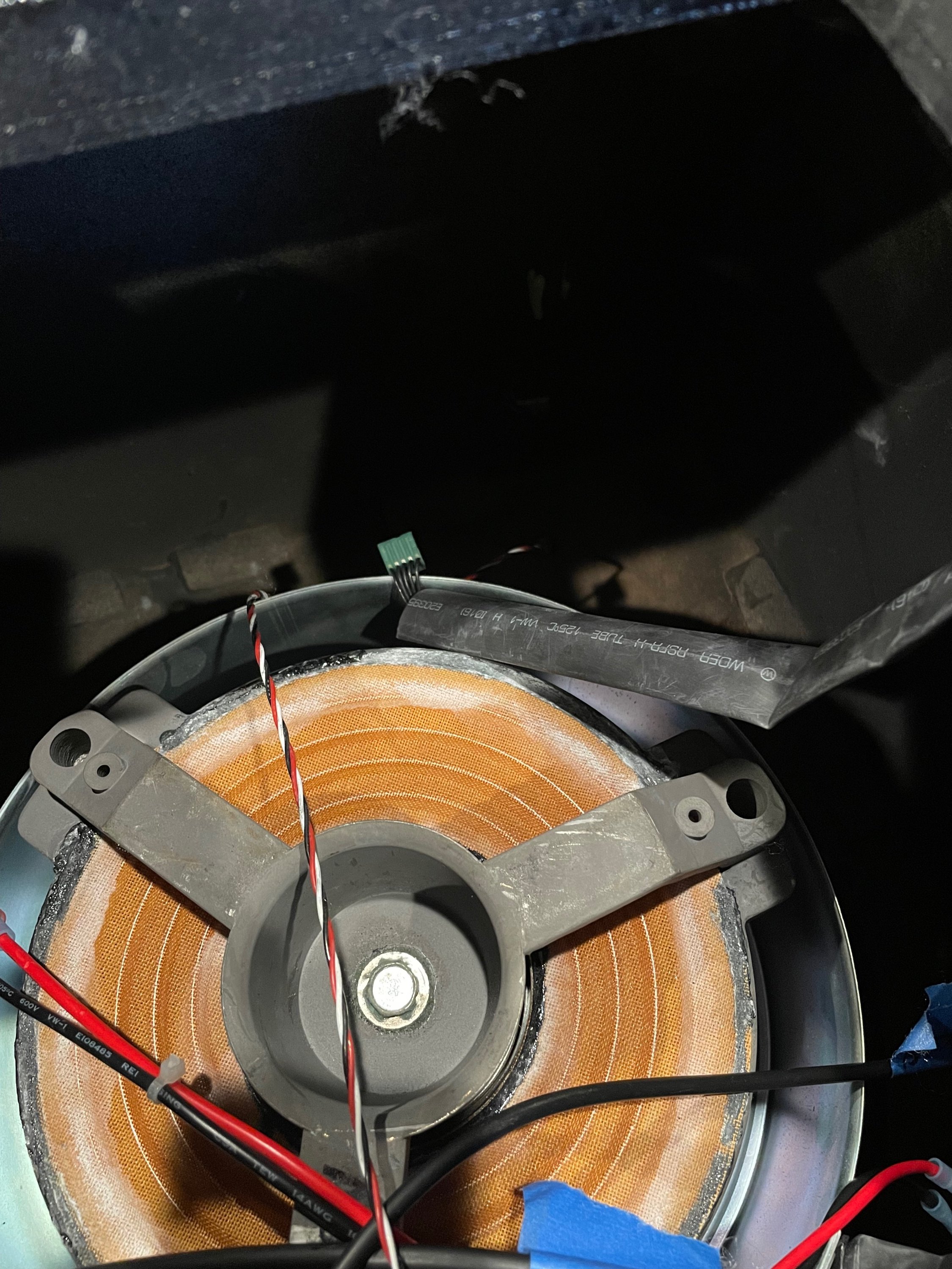

Daddyjt 9,617 Posted May 4 Author Posted May 4 Anyway, I got the plate amp back, and got it installed as quickly as I could. There’s a lot to these things - the speaker wires to the woofer, the bus wire to the accelerometer, the bus wire to the front panel mic input, bus wire to front panel IR sensor, and bus wire to front panel light. So, all hooked up and I ran an input from my 2ch rig to it just to test function. Full stop. There’s a rattle/scrape/buzz sound. Shit. My first (and worst) thought was a blown voice coil on the 18” driver. Shit, shit, shit. Uniform pushing on the cone felt “scratchy”. Damn. So I uninstall the plate amp, flip the box over and then begin the process of removing the driver. The whole time I’m thinking “at least I have a backup plate amp (all DD series subs - 10”, 12”, 15” and 18” use the exact same plate amp) for my other 18” or my 12” should either of them fail. pulling the driver is not easy - 16 Allen screws for the front bezel, then 6 more for the driver. THEN you have to get the driver out - and it’s MASSIVE - see pics. The voice coil is 5” in diameter, and a full 7” long. The magnet assembly is roughly 40lbs alone. Once out of the enclosure, the cone-push test revealed no scratch or rub. None. Now I’m starting to be a bit hopeful! I inspected the cabinet for anything loose or with potential to rattle - nothing. Hmm… 6
Daddyjt 9,617 Posted May 4 Author Posted May 4 After a bit of brainstorming, I’m thinking either one of the FIVE different wires snaking through the cabinet was making contact with the back of the cone, OR one (or more) of the driver or bezel screws were loose. The IR sensor or the driver +/- speaker wires are the most likely culprits to contact the back of the cone. Therefor I wrapped both in bubble wrap and zip ties (positioning the zip ties so that they could not contact the metal of the basket and create any noise). I also took extra care in re-stuffing the damping material, and carefully tightened and torqued all driver and bezel screws. I reassembled everything and fired it back up. Still a buzz - Damn… but wait - the noise I’m hearing is way off to my left. Way off. It’s actually my son’s cologne bottle on his vanity in his bathroom 15’ away! Whew. The sub sounds fantastic - and feels like an earthquake with a sweep tone from the Carver Reference disk. Mission accomplished - for the rest of the story, hit up the Chasing Bass thread. 7
