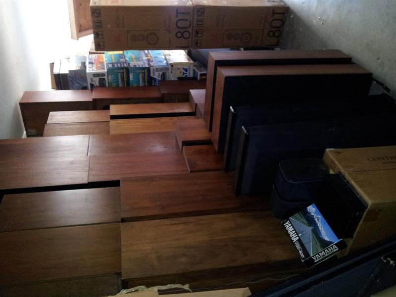

Gene C 1,748 Posted February 19, 2013 Posted February 19, 2013 Think some members on this site has us beat. I recall Steve Rocket having a garage full of speakers and audio equipment. And another fellow on here "recall the photos" with a shit ton of gear sitting on shelves somewhere. My limit is set on one side of my walk in closet floor. Once it's full that's it for me.

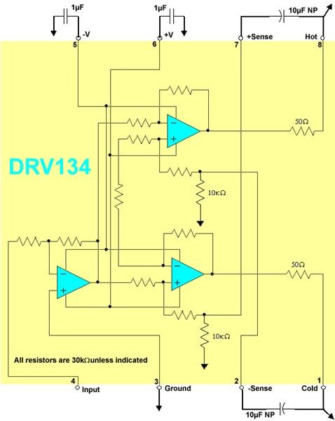

Hibernator69 47 Posted February 19, 2013 Author Posted February 19, 2013 Thanks for recco for the smaller Xover. Saw it, but wasn't sure that's what I needed. For $80 that's a pretty easy way to go ... except for the whole XLR thing. Hmm, buy adapters, make adapters, buy Carver Pro amps. WWWOCCDD? My C-11 has balanced outputs. If your preamp is single-ended you have a few choices: 1. Buy (or make) appropriate RCA to XLR adapter cables to get in (1 pair) and out (2 pairs) of the XO. While this is the simplest solution, and it works MOST of the time, it can result in a ground loop. No way to know for sure until you try it.... I've got XLR to RCA for the outputs to the power amps since I was planning ahead with the Ultradrive Pro. Will have to check if I have any RCA to XLR adapters though. Had wanted to use digital in, but never ordered the right converter box for either toslink or coax to whatever the Behringer needed to accept digital in over the XLR input. Ground loop doesn't mean anything to me yet (other than it is presumably not good). I think I've seen various descriptions of converting XLR to RCA by splicing the CLR's + and - pins together. Can't recall seeing any descriptions of the other way around. Or maybe it's that the Behringer accepts unbalanced input and thus a simple adapter plug was sufficient.
Hibernator69 47 Posted February 19, 2013 Author Posted February 19, 2013 3. Convert your preamp to balanced outs with an internally mounted PCB (about $30 worth of parts). Here's the circuit and PCB BillD designed for my C-2 and C-11. (I have a parts list too if you are so inclined.) YEAH! ME WANT!!! It's on the ever growing list of things I hope to be able to do one day ... sooner than later comes to mind, but we'll see.
zumbini 6,150 Posted February 19, 2013 Posted February 19, 2013 Ground loop doesn't mean anything to me yet (other than it is presumably not good). A ground loop occurs when there is more than one electrical path to ground. It usually manifests as 60 cycle hum that is independent of system volume. I think I've seen various descriptions of converting XLR to RCA by splicing the CLR's + and - pins together. Can't recall seeing any descriptions of the other way around. Or maybe it's that the Behringer accepts unbalanced input and thus a simple adapter plug was sufficient. Yes, the Behringer will accept a balanced or unbalanced input. I wouldn't bother building your own cables until you know it works. Besides, Monoprice sells pro-grade RCA/XLR cables dirt cheap.

galaxyoilcan 88 Posted February 19, 2013 Posted February 19, 2013 Think some members on this site has us beat. I recall Steve Rocket having a garage full of speakers and audio equipment. And another fellow on here "recall the photos" with a 5hi7 ton of gear sitting on shelves somewhere. My limit is set on one side of my walk in closet floor. Once it's full that's it for me. I could probably quit anytime I want. However, I have an affinity for Infinity and other great old vintage speakers and the beautiful real wood veneers on them. most of the old speakers on my "wall of shame" still sound great and get a chance to prove it on a rotating basis. A few are due for new surrounds and some are projects that need attention (Maggies, Boston Acoustics). Most of the components in the boxes are demo video decks and other home theater stuff from my years with JVC military sales. Nearly all the good ol' analog electronics are inside with me.
