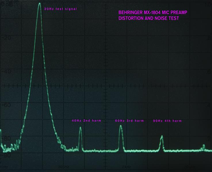

basspig 62 Posted March 2, 2012 Posted March 2, 2012 Very interesting test.. 20 Hertz signal, driven to Bassmaxx ZR18s, SPL of 110dB as measured on SPL meter. Behringer ECM8000 omni capsule mic measuring the sound, fed to Behringer MX1804X mixer, output of which drives Tektronix AA501 Distortion Analyzer and HP 3580A Audio Spectrum Analyzer. Not taking into account hum and noise, the distortion reading (unweighted) is 0.4%. On the spectrum analyzer, with the test signal stopped, there is 60Hz hum at -60dB, accounting for at least 0.1% of the total distortion reading. Of course there are many other factors, including room boundaries vibrating and re-radiating their own distortion, so this test is not completely accurate and probably contains much noise which adds to the THD % figure. I suspect as such, because distortion seems to go down as I increase level, up to a point. The measurement mic has a distortion rating of 1% at full input at mid frequencies, so it's probably higher at very low frequencies and only kept down because the level at which the test is conducted is below the mic's max SPL. 110dB seemed to be the sweet spot between noise floor and room/mic distortion. It is safe to say that any distortion produced by the subwoofer is way below 1%. If I could test in an anechoic chamber with a mic that has zero distortion, I could get a better picture of what the ZR18s are doing, but even with the distortion introduced by the environment and test setup, the figures look pretty darned good for a subwoofer. Even with the sound system shut off, there is still a big spike at 60Hz on the spectrum coming into the distortion analyzer. No doubt that is contributing to the reading as it shows up as a third harmonic. Ground loops place a lower limit on THD tests because the noise is counted as distortion.

basspig 62 Posted March 4, 2012 Author Posted March 4, 2012 I've been analyzing my test setup and have found some alternative wiring methods to get the 60Hz hum down another 20dB. In the process, I took distortion measurements on the AA501 analyzer and found that the mixer, preamp I'm using contributes .03% distortion itself. I am now taking the pre-EQ/Fader output to get rid of some noise and distortion. Another issue is the blocking capacitor downstream of the phantom 48VDC.. it's dropping the fundamental output because the response rolls off somewhat by 20Hz. (the 90Hz should be 80Hz --typo) At least the setup is much cleaner now, and I measured the noise with the mic plugged in, and it is -84dB below preamp clipping, which represents 0dB at the top of the HP 3580A display. The noise floor is showing about -90dB at frequencies other than 60Hz. As soon as I can get everyone out of the house, I'll conduct a followup test. Also try some different mics to see which mic has lower distortion. 1

basspig 62 Posted March 4, 2012 Author Posted March 4, 2012 I switched out the ext proc loop and the Sonic Hologram, swapped the Behringer ECM8000 mic for the B-1 mic, and with 20Hz @ 110dB, the total harmonic distortion reading of the Bassmaxx woofers in operation shows 0.27% on the Tektronix AA501.
