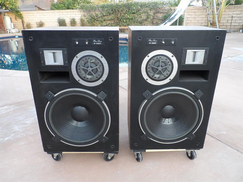

fill35U 1,850 Posted February 23, 2015 Posted February 23, 2015 FWIW there's a pair of Phase Linear PL-580 speakers on eBay HERE : Note the beryllium tweeters! Made by Pioneer / TAD for PL. From the description: "Tweeter is ribbon with responce up to 120khz with efficiency of 96.5dB (SPL/W at 1-meter distance).Mid-Range is a dome-shaped driver with dual suspension system utilizing a pure beryllium diaphragm held by wire suspension and tangential suspension. Woofer is 15 inch dia. with usable reponce down to lowest octave, magnet is 8 inch dia. ferrite. Network can be by-passed for tri-amp config. and encloser is made of Apitong veneer board. The weight is 103lbs each, freg range is 28-120,000hz." And a link to more info about the P-series speakers: Phase Linear P-series speakers at stereomanuals.com
kingman 663 Posted February 23, 2015 Posted February 23, 2015 Wouldn't mind getting an ear on those bad boys!!!
TNRabbit 371 Posted February 23, 2015 Posted February 23, 2015 you could have 2 really nice pair of Amazings for that price....
