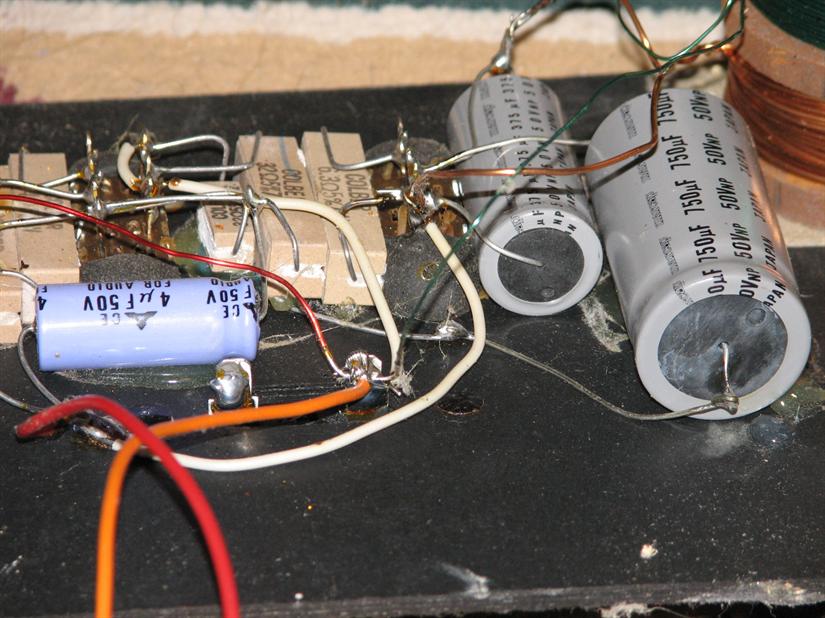

BillD 239 Posted November 29, 2009 Posted November 29, 2009 Well' date=' there usually aren't any electrolytic capacitors in "good" speaker crossovers. If there are, they are non-polar, because sound is by its nature AC. Other types of caps don't "dry out" like electrolytics.[/quote'] What kind of caps do you find in Plat crossovers? I probably shouldn't have been so cavalier in my statement. Non-polar caps are used when the capacitance gets so high that film caps become impractical. For instance the plats have two non-polar caps in them, one which should be replaced with a film cap (150µF) and one that probably cannot (450µF).
BillD 239 Posted November 29, 2009 Posted November 29, 2009 Yeah, that picture looks different than the other one. I wonder why one is 4µF and the other is 4.7µF? Regardless, they should be the same. Here is a good replacement for the 4.7µF. And, if you want your loudspeakers to sound the same, both caps should be the same value! You could tie a 500µF and a 250µF capacitor together in parallel together to get 750µF and a 250µF and a 125µF to get the 375µF. All of those values are available at Parts Express too.
ggans2 0 Posted November 29, 2009 Author Posted November 29, 2009 Thanks Bill, The voltage on that link for the 4.7 is not 50 volts, If it has a higher voltage does that matter ? Higher is Ok but lower is not? I'm trying to learn.. Edit to ad, the 4uf and 4.7uf are from different pairs of walsh 2 speakers. Maybe three years apart. The crossovers look the same other than that one cap and the red ones that have Ohm printed on them.. Not knowing the reason why they are different does it really matter..?? hum..
BillD 239 Posted November 29, 2009 Posted November 29, 2009 Higher voltage is fine. If I were you, I'd try to find the value that was used in the latest build and use that.
ggans2 0 Posted November 29, 2009 Author Posted November 29, 2009 I have sent an email to every supply company I could find on the net asking if they have these caps. So far I could not find the 75o and the 375uf. I wonder what Ohm is doing, I'm not spending $350 to find out but if these caps are not avilable they must have another way because it's on there web site.. I suppose I can call them and ask..

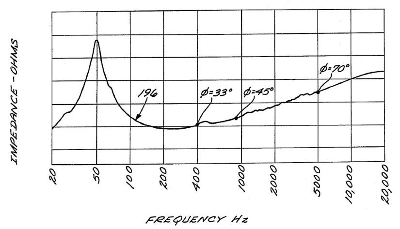

ggans2 0 Posted November 30, 2009 Author Posted November 30, 2009 Seeking hand wound custom caps. lol just kidding.. I don't think there are any of these on the planet.. Question thou, what determines the impedance of a speaker? The crossover the voice coil, both?
ggans2 0 Posted November 30, 2009 Author Posted November 30, 2009 Update, I called Ohm and spoke to a teck, he told me I could use two caps to get to the value I need. He also told me the caps I have now were custom made for Ohm which Is why I cant find them. BTW The guy I spoke to was John, the President of Ohm Speaker... Now on to recapping my C-2..
BillD 239 Posted November 30, 2009 Posted November 30, 2009 I'd get those NP electrolytics from Parts Express.
ggans2 0 Posted November 30, 2009 Author Posted November 30, 2009 Yep, that's what I am going to do.....
BillD 239 Posted November 30, 2009 Posted November 30, 2009 Did your guy say whether to use 4 or 4.7µF for that other cap. 4µF is kind of oddball. 4.7µF is a common cap.
ggans2 0 Posted November 30, 2009 Author Posted November 30, 2009 I asked him about that, I told him I had two pairs about three years apart and was wondering why the two had the different cap's. He did not know for sure but speculated that they must have wanted to change the sound of the speaker at some point. The walsh 2 was in production for many years. I asked which he would use and he said he would pick something in the middle like a 4.3uf.. However I have not looked for one. BTW The caps at parts ex are not listed as to who makes them. I was told about Bennic caps today so I looked at them also, any opinions I'm all ears.. Also is there a best way to combine caps? Three 250 to get 750 instead of a 500 and a 250? inquiring minds want to know..
RichP714 3,174 Posted November 30, 2009 Posted November 30, 2009 .....Question thou' date=' what determines the impedance of a speaker? The crossover the voice coil, both?[/quote'] Many things determine the overall impedance of a loudspeaker. Here is a typical impedance plot of a driver in free space You can see the impedance varies dramatically with frequency; a static DC measurement doesn't give you the whole story. There's a peak at driver resonance (about 50Hz) and a gradual rise with frequency. The point somewhere in the 200-400Hz range is nearly 4 ohms; the 'rated' value of the driver. Now, put this driver in a cabinet and the acoustic properties of it's evironment also contribute. The mass and air coupling of the driver can be thought of as inductance, the suspension compliance (spider and surround) as capacitance, and frictional losses as resistance. All these new additions will change the plot. NOW, put a crossover in circuit, and you change the playing field again. Capacitors and inductors will introduce phase leads and lags, changing the plot again. Also, some crossover networks employ zobel networks, to compensate for the increased inductive reactance of the voice coil at higher frequencies, and they will also change the plot. 1
ggans2 0 Posted November 30, 2009 Author Posted November 30, 2009 Wow, there is a lot more to this then I ever knew, I'm still trying to figure out how these coils work. All that magnet wire, are all speakers like this.. I also guess that amp power measured in watts dose not mean a whole lot, more like small medium and large amp makes more sense..lol Btw One of these were recommended for the 4.7uf..
RichP714 3,174 Posted November 30, 2009 Posted November 30, 2009 .....are all speakers like this....... Any electro-dynamic transducer will behave this way. Electrostatics are a different paradigm, mostly capacitive reactance. The voice coil windings (or trace runs in a planar type transducer) behave essentially as an inductor, so impedance climbs with frequency.
