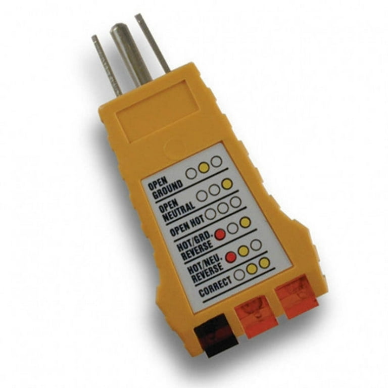

BobTFM35 3,244 Posted June 1 Posted June 1 Maybe you can do this as a start. Purchase a Receptacle Tester sim to this item. As you can see from the legend it will give you a good indication of the wiring status of the receptacle you plug it into. Having a Receptacle Tester I think is a must to have in your tool bag for a start. 2 1
