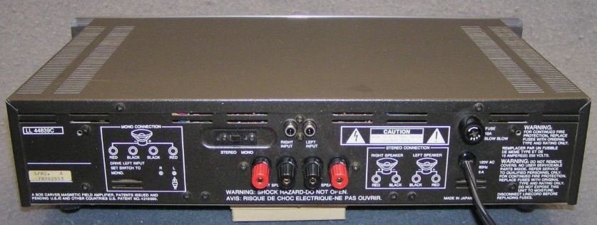

w3wilkes 129 Posted March 10 Author Posted March 10 First dumb question. This welcome section, or better stated, this thread seems to be as good a place as any for my questions regarding what I've bought but haven't yet received? Or should I be asking questions somewhere else? And I appreciate all the welcomes from you all! Comment: I've eyed Carver with some envy for years (decades) but never felt I could justify buying higher quality gear than I have. The only "extravagant" piece I ever bought back in the mid 1980's was my ADS L810's which I really like but have never had real power to drive them. Well, I pulled the trigger and bought the 2 Carver pieces in my sig. and am pretty excited for them to arrive and get hooked up, probably Saturday. Second question: The M-1.0t that I bought is serial # 70902593 (with stereo/mono switch), looks brand new from the pictures. Google says M-1.0t's were US made, but the picture posted of the rear clearly shows Made in Japan. I have no issues with Made in Japan and typically find their manufacturing as good or better than USA made. Since this is probably a "later date" build I'm wondering what kind of differences would have been made in circuit design, things like correcting the power on/off "thump". Was this ever done in the original manufacture specs or was "thump" correction always a repair thing? Curious minds have a need to know.
