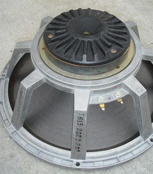

zumbini 6,154 Posted August 5, 2012 Posted August 5, 2012 Is this more like what you think it should look like?
VTypeV4 37 Posted August 5, 2012 Author Posted August 5, 2012 Yeah, just like that Z but as you see, mine aint! Wonder if its a predecessor or something?
zumbini 6,154 Posted August 6, 2012 Posted August 6, 2012 I'll hazard a guess that your stamped frame was for home stereo and the cast frame for musical instrument/PA applications.
kve777 6,911 Posted August 6, 2012 Posted August 6, 2012 I'll hazard a guess that your stamped frame was for home stereo and the cast frame for musical instrument/PA applications. Judging by all of the EV speakers I've seen over the years, Z is correct.
VTypeV4 37 Posted August 6, 2012 Author Posted August 6, 2012 Many thanks gentlemen.. So would you say I'm safe to assume it is an EVM 15-L at heart and that it's 200w rating stands true? Not quite sure what I'll use it for yet but I can't see me hammering it..
VTypeV4 37 Posted August 12, 2012 Author Posted August 12, 2012 Righty ho! After lots and lots and lots and lots of google trawling, I found what my 'mystery' EV 15 incher is.. Its an EV SRO15, predecessor to the legendary EVM series. Depening on where I read and how to interpret the specs, it's rated at somewhere between 60 and 300w so I'll assume 150w to be a safe figure. It certainly looks good for it. As I understand it, the EVMs came in about '77 but there was a bit of a crossover period where they were making both pressed and cast frame SRO as well as EVM units. Mystery solved and I think it will go nicely in my old WEM cab replacing the current HH driver once I've rebuilt the 2x12 with my newer 12" EVs.. There will be a build log with photos when I press on with it.. Now, how is Z getting with those big 18" subs..!?
