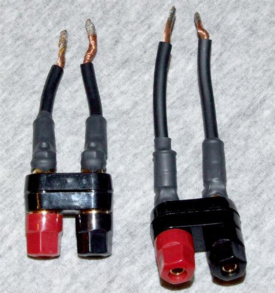

zumbini 6,154 Posted December 2, 2012 Posted December 2, 2012 I don't recall what style binding posts are on the 901s but it's pretty easy to make adapters. Here's a set of binding post adaptors that RodH made to fit the spring clips on an M-400:

Belvedere2 242 Posted December 2, 2012 Author Posted December 2, 2012 I don't recall what style binding posts are on the 901s but it's pretty easy to make adapters. Here's a set of binding post adaptors that RodH made to fit the spring clips on an M-400: The posts are just that; posts with a nut on top. Just wrap the wire around it and tighten the nut. Those adapters would work just wrap the wire but I'd like something more solid. I'll probably have to delve into them.

zumbini 6,154 Posted December 2, 2012 Posted December 2, 2012 Those adapters would work just wrap the wire but I'd like something more solid. I'll probably have to delve into them. In that case crimp some spade lugs on the bare wire ends and you're golden. 1
Belvedere2 242 Posted December 2, 2012 Author Posted December 2, 2012 Those adapters would work just wrap the wire but I'd like something more solid. I'll probably have to delve into them. In that case crimp some spade lugs on the bare wire ends and you're golden. Thanks! Never did like that bare wire. I've used those before for automotive tasks but when it came to my speakers I never used em. Must be some brain malfunction.
