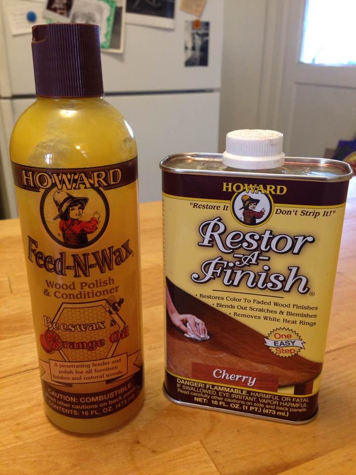

morris 390 Posted October 29, 2017 Author Posted October 29, 2017 The refurb is complete and the speakers sound great. Much improved. Now I need to see what I can do to fix all the scratches like the one seen here on top. 1
Chops 694 Posted October 29, 2017 Posted October 29, 2017 I used this on my Genesis II's. Excellent results! 1
Chops 694 Posted October 29, 2017 Posted October 29, 2017 And these Minwax Stain Pens first for the touch-up...
