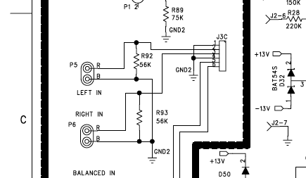

wrf 5,335 Posted March 8, 2018 Posted March 8, 2018 Schematics for the TS EQ sub show a load of only 56K. Should be just fine. Likely the same for any other sub.
Chops 697 Posted March 8, 2018 Posted March 8, 2018 Yes, too high for the amp to even notice, but the benefit is that the sub would then have the "sound" of the amp feeding it.

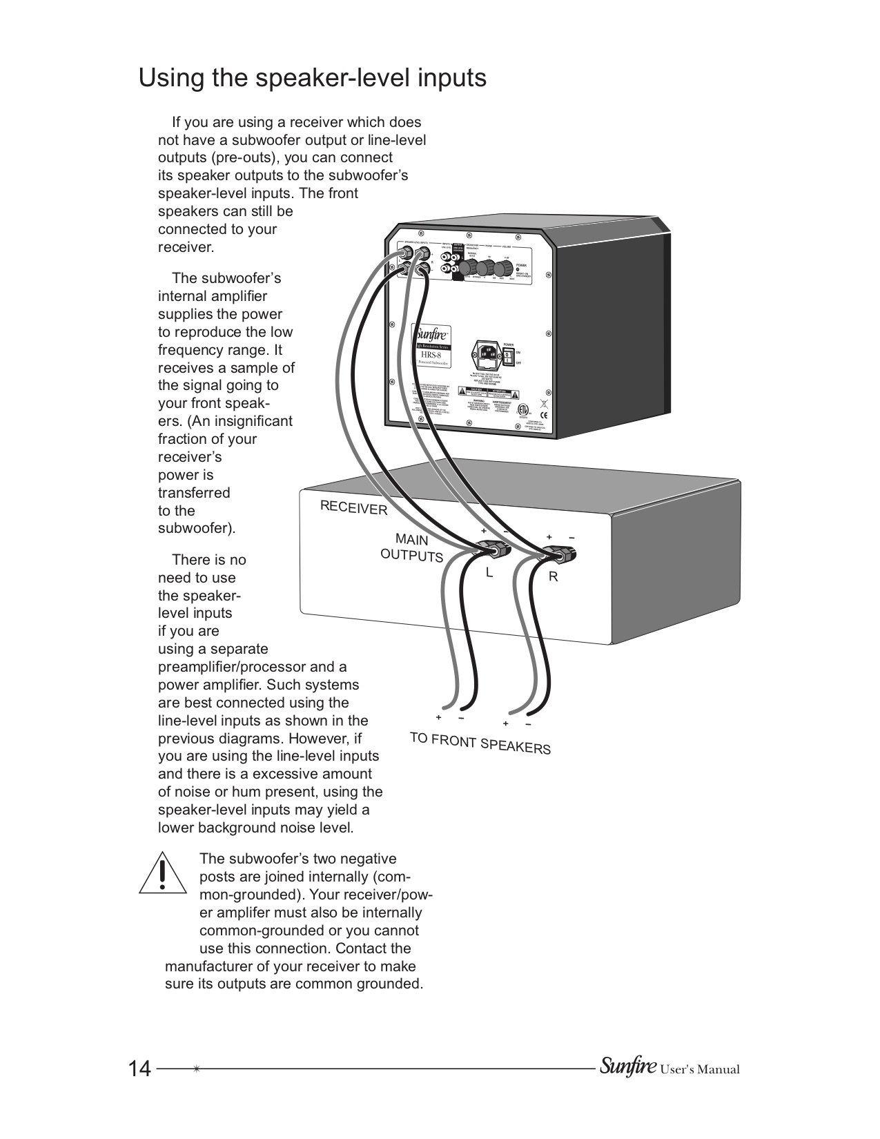

UncleMeat 1,175 Posted March 9, 2018 Posted March 9, 2018 (edited) Make sure you don't use a bridged-mono amp, or an inverting amp. On the my Sunfire subs the signal ground of the speaker level input is also an earth ground. The manual says not to; but who reads that first??!! Edited March 9, 2018 by UncleMeat

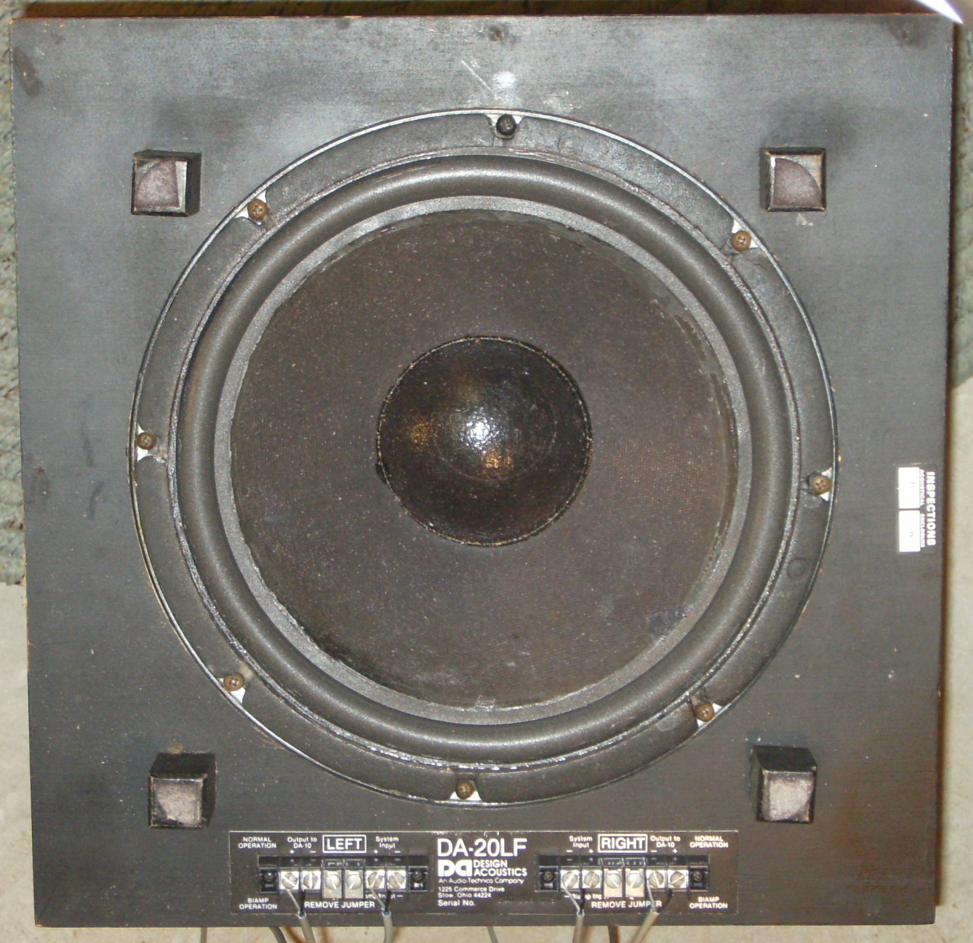

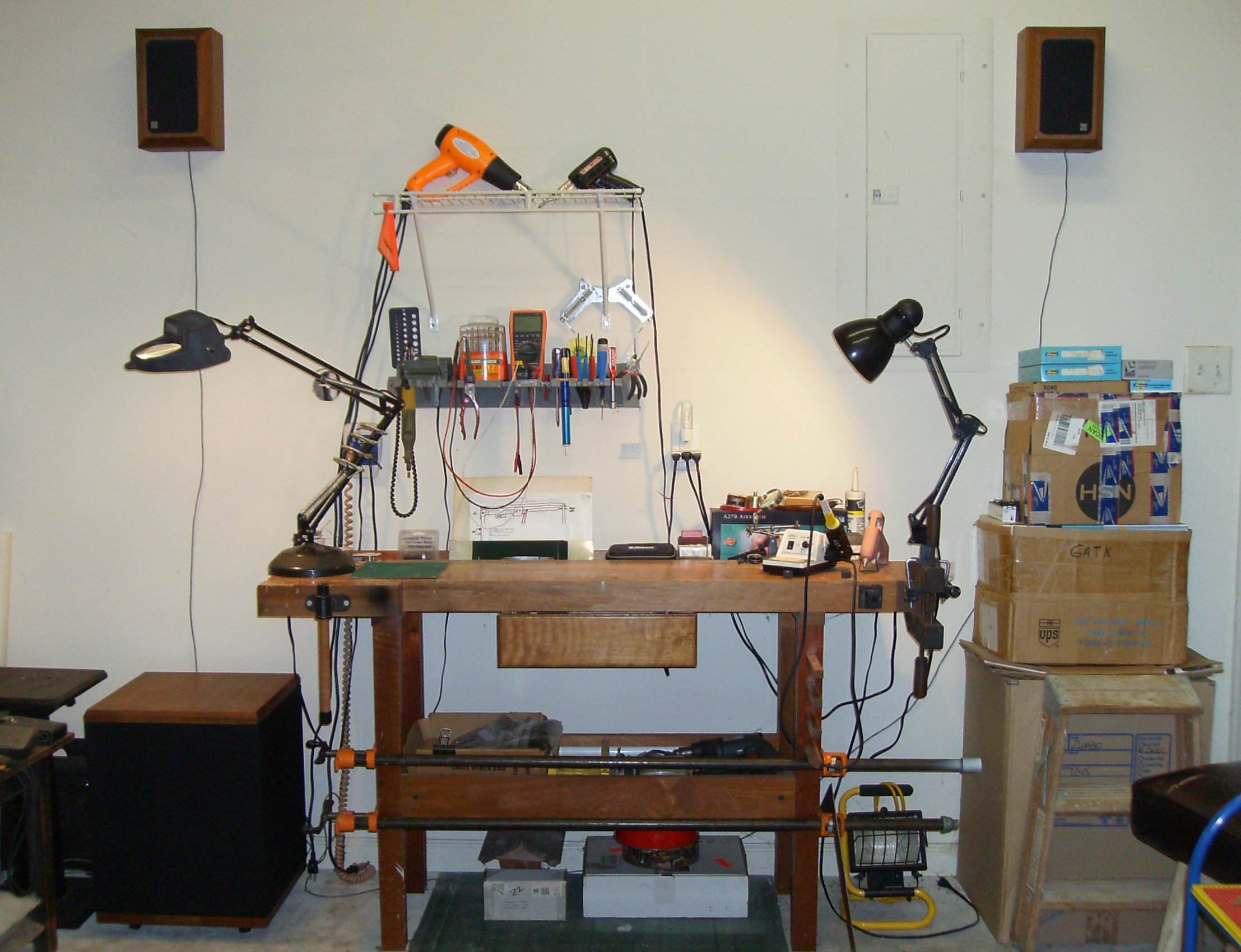

zumbini 6,154 Posted March 9, 2018 Posted March 9, 2018 I assumed from your original post that it was (would be) an active sub. Passive subs and sub/sat system are intended to be driven directly by an amp. The Design Acoustic DA-30's (a DA-20LF sub with 2 DA-10 satellites) I bought in the late 70's and now use in my shop are set up that way (full range speaker-level signal to the sub, barrier strip outputs to the satellites. They aren't earth-shakers but sound excellent at reasonable listening levels.
