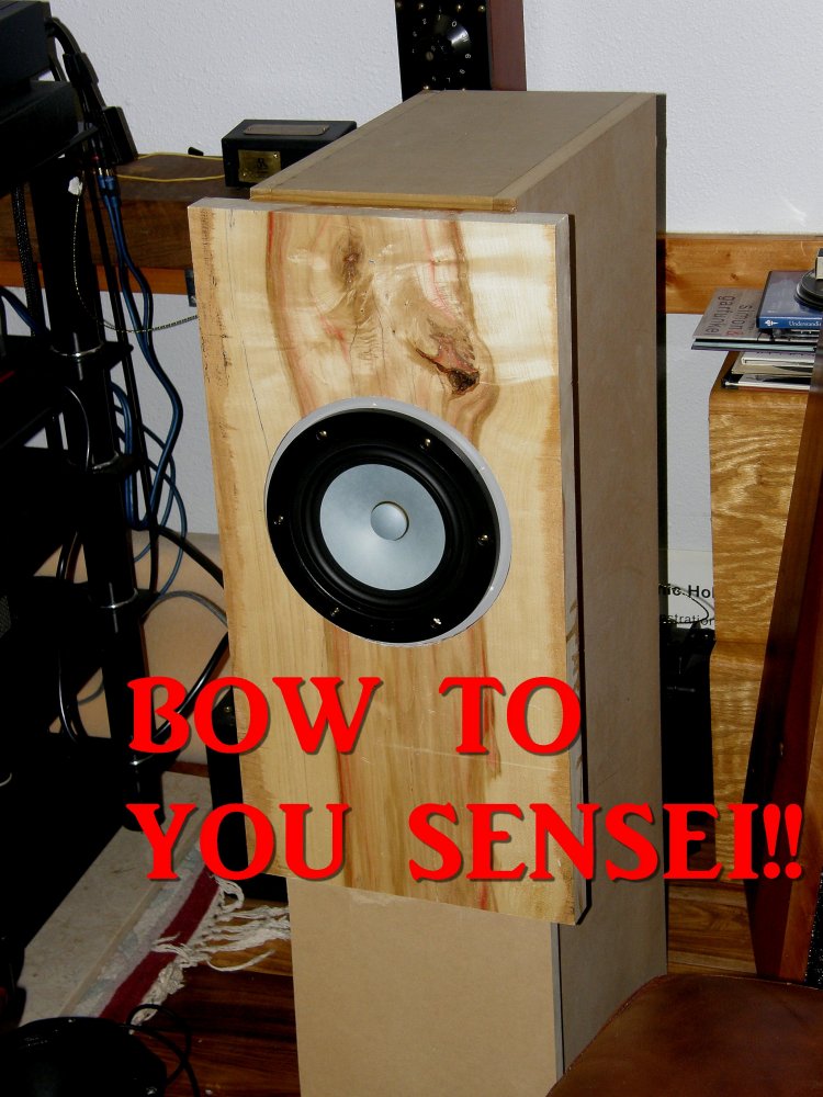

4krow 6,640 Posted January 30, 2020 Posted January 30, 2020 In my corner of the world, experimenting is a must. The latest what if came to me when I listening to my room (not my speakers) and wondered if a short horn would have a beneficial effect on the presentation. Unfortunately, the short answer seems to be yes, and so after the experiment, I must find a way to attach the short horns more permanently to the driver front. Still will have the option to take them off in the future. 3

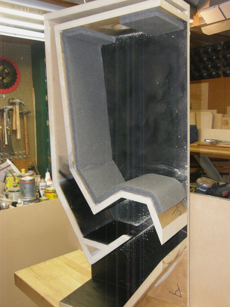

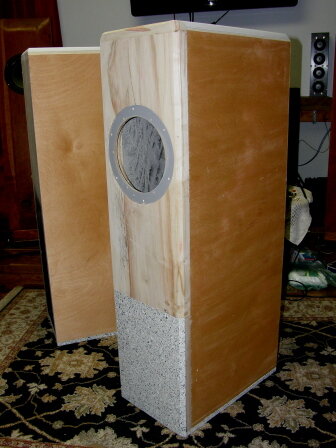

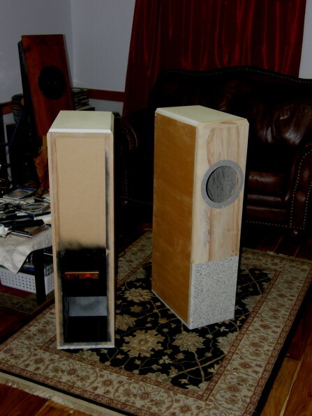

4krow 6,640 Posted June 20, 2020 Author Posted June 20, 2020 GOD! Only one step closer. I have added the second layer of cabinet to this set. Now there is no need to insure them, they can't be moved. So, I found some Corian at a surplus store, AND two pieces from the local church. Well, what would you do with a bunch of Corian? I would slap them on speaker cabinets and dull a couple of router bits to trim them up with. Until the next part comes in, I have to have another listen. Maybe the bass will be better (heavier). 2 1
Brian_at_HHH 2,706 Posted June 20, 2020 Posted June 20, 2020 Nice work! I rather like the look of the corian on those, and yeah, it ought to make them pretty darn stable. Hope it has the desired effect on the bass. Those are starting to look really good. Flipping back to your earlier picks, you are FAR more than one step closer. There's been a lot more work on those in the mean time that you aren't admitting to. 2
4krow 6,640 Posted June 20, 2020 Author Posted June 20, 2020 Brian, Have you been crouching in the hedges again? Why yes, I have taken many showers after numerous routing sessions. The Corian is very fine, and I will be glad to be done with it. Hmmm, this message isn't reading like I wanted it to. Anyway, bushes aside, some of the unmentioned includes layers of 'acoustic paint' between some of the layers of the cabinet walls, many many clamps in all directions, and still a gap, well glued in place the next morning when I went to check on the condition that my condition is in. These had better sound even more impressive than before. I need them to, my chiropractor needs them to, my massage therapist needs them to, and then there is my psychiatric team who really need a break from me. 5

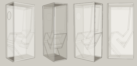

4krow 6,640 Posted June 21, 2020 Author Posted June 21, 2020 Dude, Sometime later, these will be finished and much more worthy of photos. I appreciate your interest. The plans for this model can be seen at Decware Audio. I made the model DNA2, which are just a set of enlarged plans for the original DNA model. That model has some great ideas for smaller bass horns such as this. 2 1
