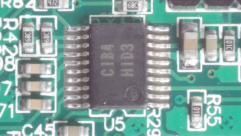

DMRECONE 15 Posted February 5 Author Posted February 5 (edited) Spoiler AndrewJohn - I whent through YouTube and could not find anything on SDS12 repairs. I checked on "Supreme Innovation" channel and nothing there either on the SDS12. The SDS12 isn't like the other Sunfire subs, it uses a class D IC for output. I have already repaired the power supply but there is also an issue in the input / amplifier board. I'm pretty sure the class D IC is bad but it is controlled by an STA309A Multi-channel digital audio processor with DDX. There is one IC that I can't identify - TSSOP-20 package marked C1B4 and under that H1D3. I have searched extensively and can't find any datasheet or information on the chip. Can't tell if tit's a controller or an eprom , it is connected to a 4 pin header that I would think is for loading firmware. Having a schematic would eliminate the guesswork. Edited February 5 by DMRECONE 1

DMRECONE 15 Posted February 6 Author Posted February 6 Thank you Sk1Bum - Here's the IC I can't find anywhere. 2
Half Life 1,957 Posted February 6 Posted February 6 Take all this with a grain of salt as I've never worked on anything by Sunfire (yet). Lots of speculation here from looking at the pic you posted. First, note there isn't a readily identifiable logo (I don't believe the M02 inside the circle is an actual logo). I compared it to known IC chip logos, including the JEDEC database of manufacturers - no match. The other markings could be just "house codes" like factory, date, batch, etc. I do not believe that Sunfire actually made any of their own IC's and this is likely a custom for Sunfire. It could be a PIC (controlling auto on/off, muting, etc.). However a PIC in this instance would be overkill. It could be a simple ASIC, controlling those same functions (more likely); ASIC's would be a lower cost at volume part for something like this. To narrow this down a bit, you'd have to do some circuit level sleuthing. You'd need to map out the pins and surrounding circuitry, taking note of signals/voltages on the pins of the device. From there you should be able to make an educated guess as to what it "might" be. Again, all of this is pure speculation. I have absolutely no experience or knowledge of Sunfire circuits. However, I do have experience in reverse engineering circuits containing unknown/obsolete parts. What I described above is how I would tackle this if I were working on it. Good luck!

DMRECONE 15 Posted February 6 Author Posted February 6 OK after some very intensive searching and a bit of shear luck, I think I may have found out a little information of the IC. It appears to be a RENESAS R5F211B4SP R8C/1A Group, R8C/1B Group SINGLE-CHIP 16-BIT CMOS MICROCOMPUTER. The chip is now obsolete and out of production as far as I can tell. I submitted a service request to Renesas for more information on the screened markings on the chip. The datasheet does state that some models of the chip can be preprogrammed by the manufacturer. Now I'm waiting for a reply and maybe more information on the specific properties of this particular model of the chip. I hope the chip is not damaged as finding the firmware I'm sure will be impossible. Since Sunfire became a subsidiary of Nice North America service and tech info is pretty much non existent from the manufacturer. 2
BobTFM35 3,480 Posted February 6 Posted February 6 @DMRECONE Coupled with your finding in your above post and using a search on your image I hit on this. It might have a chance of being "the chip" and I don't know how to proceed after this. 【Naxin Electronics】Original imported R5F211B4SP C1B4 microcontroller MCU microcontroller chip power supply IC_ Huwo Tao 1
DMRECONE 15 Posted February 6 Author Posted February 6 Yes , I found the same chip and others with different screened lower marking. I'm hoping I can get more clarity on the lower marking from Renesas. I'm thinking it might be either date coding or end user specific code for installed firmware. 2
