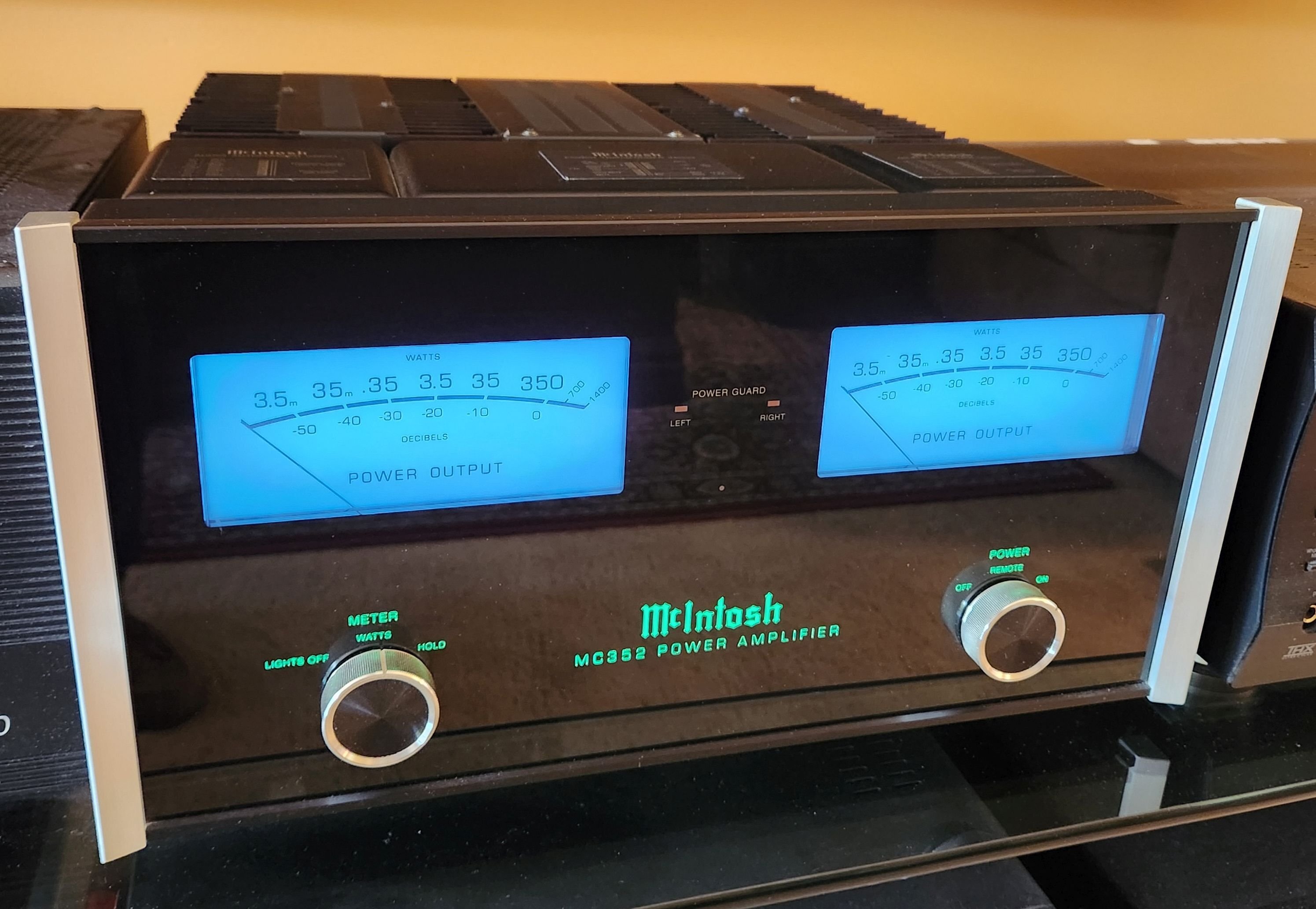

All very good questions. The McIntosh amp you see below is a MC352 stereo amp designed by Gordon Gow (one of the founders of the McIntosh company ) that has both solid state transistor outputs and also output transformers (look for them on the right and left in photo right behind the faceplate). They are bifilar wound transformers. Amp has 4 separate amplifier circuits in it. Each amp section handles 1/2 of the musical wave (top vs. bottom) and the trannies are some of the finest sounding transformers in production today. In fact there are lots of McIntosh amps and perhaps other brands that have the same configuration, so yes it has been done. Its an incredible sounding amp and although it does not sound like a tube amp it is very smooth and clean when you listen to it even at ear blistering levels. Listening fatigue is very low even after hours of listening. I believe this is attributed to the quality of the trannies and their bifilar nature. It is the most expensive type of transformer to manufacture. Regarding the 'cone movement' and 'Carver Challenge' Bob told me that before he even entered into the challenge he had already duplicated the null matching in his own lab. But he was also using an oscilloscope and perhaps other tools to monitor the difference signal between his amp and the challenge amp. So he probably achieved the 'least' difference in speaker movement (or oscilloscope trace difference) because getting 100% null is probably near impossible. The trick is to get it just below the level of human perception of the difference. So this does not not necessarily mean the amps had the same damping factor at all. In fact it would be highly unlikely that they had exactly the same damping factor but the null process may have assisted in reducing the overall difference between them somewhat. Remember the 'cone control' for the null test is less about cone control and more about nulling the difference signal between amps....you are using cone movement (or oscilloscope trace) to detect the amount of difference...and you might just have to ask Bob for a definitive answer on that point. It would be a very interesting result if the entire null process made the damping factors equal...so I'm not ruling that out because it would be very interesting to consider but I suspect there is much more at play here between amps than just damping factor (like significant distortion products, transient response characteristics and phase related anomalies in the two amp signals). Regarding your last question tube amps have been designed WITHOUT output transformers but the tubes are a special type and only work in circuit designed to accept them. I have been told that these amps have a 'live' and 'zippy' sound, not at all like the smoothness of tubes. But they can operate completely devoid of matching output transformers. A good example is the Futterman OTL Amp: https://jacmusic.com/techcorner/ARTICLES/English/Harvey-Rosenberg/futterman.htm BTW - I don't think you can build a tube amp with power transistors - its a mismatch from the start since circuit-wise they each have very different operational requirements. However you CAN build transistor amps with MOSFET transistors which sound more like tubes than transistors because their distortion and clipping characteristics sound more tube-like.

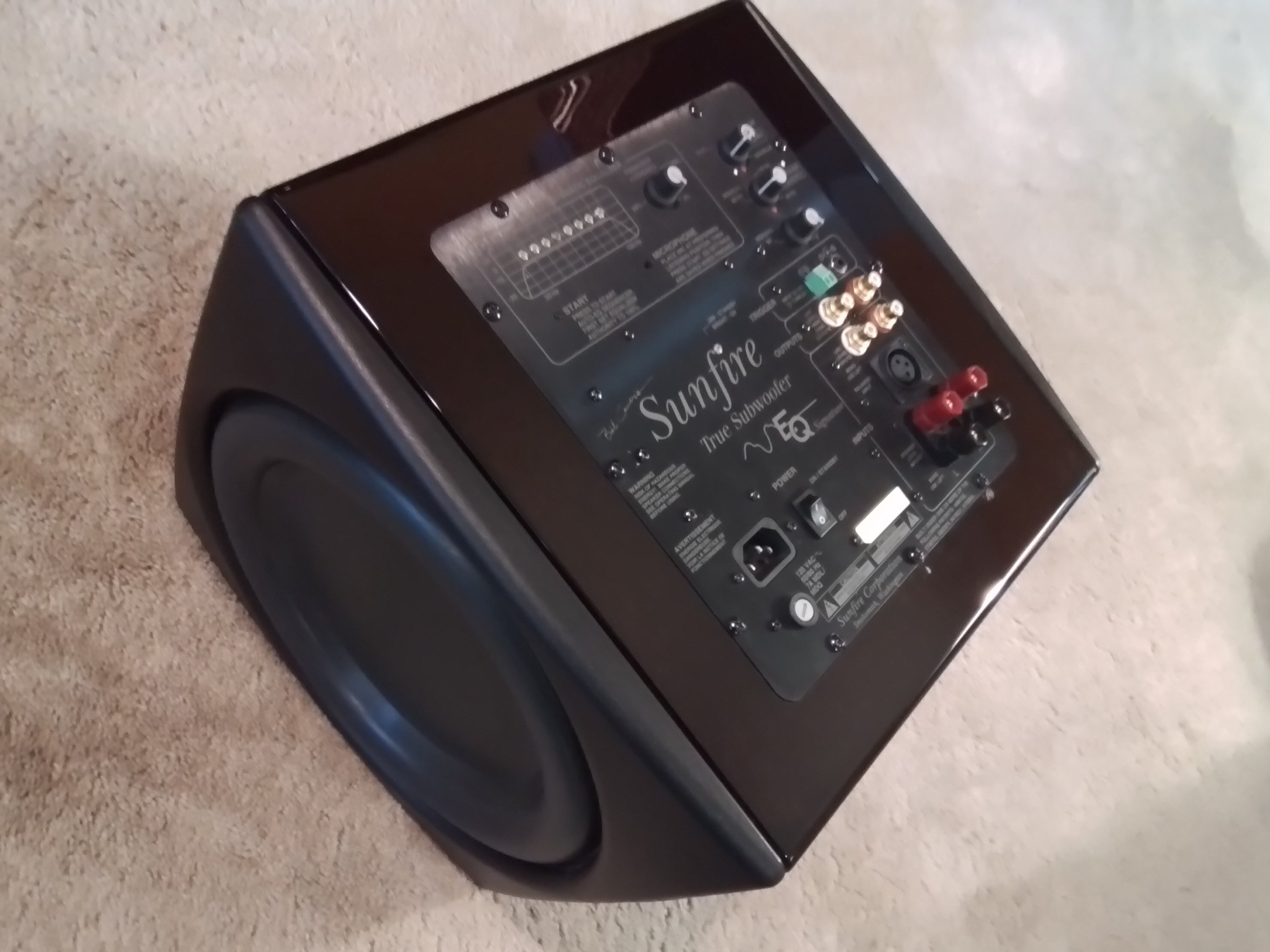

This has also been my experience with dual voice coil woofers and somehow using those two channels seems to make it a bit more dynamic than when driving with one channel only. I have owned Bob's Sunfire True Subwoofer EQ...with its built in EQ, passive radiator and 2700 watt amp for many years now...its a killer unit. There is nothing else that can rumble the walls for movie soundtracks or stereo listening. Just got it back after recent repair at Deltronics.

One possible advantage of DVC subwoofers is the ability to drive the subwoofer with more power and spread the drive wattage across two voice coils instead of just one. Will this make a difference in bass dynamics or perceived quality of sound output? That would likely depend on your particular subwoofer design. Its easy to find out though...just drive it with one channel (L) of a stereo amp and listen....then change over to driving it with two channels (L+R with mono input) to hear the difference and let us know what you hear. Some SW models might perform better with two channels driving them but others may not. The back EMF of two channels may do a better job of controlling the SW driver movement. However the damping factor of the amplifier may play a bigger role in the SW sound than the number of channels you drive it with.
