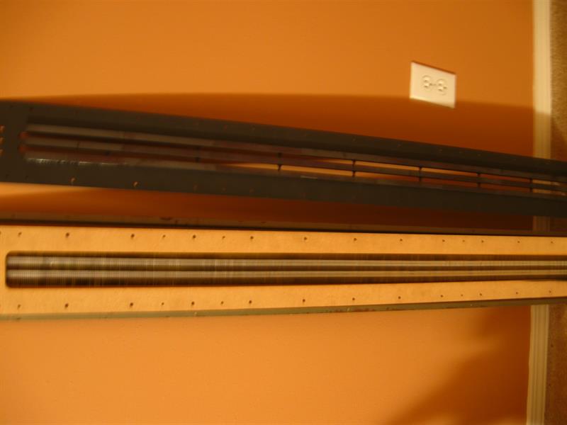

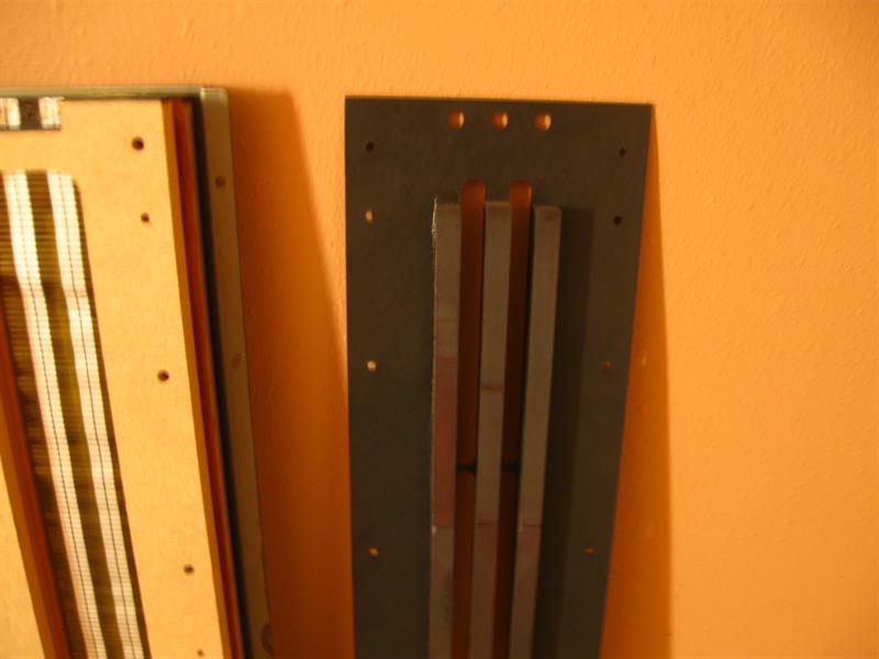

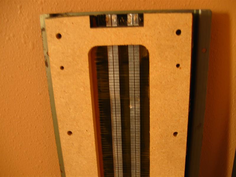

srinath 34 Posted October 18, 2014 Posted October 18, 2014 The ribbons look like this when taken apart. Cool. Srinath. 2

RobertR 849 Posted October 18, 2014 Posted October 18, 2014 Srinath, A couple of questions on your ribbon work, as I can't help being curious: Did you ever really take that ribbon all the way apart, somehow without totally destroying the Kapton, or did you stop at the point where the picture shows it? Did you ever get that (or any other) malfunctioning Carver ribbon successfully back together again, repaired and working correctly? RobertR 3
srinath 34 Posted October 19, 2014 Posted October 19, 2014 Srinath, A couple of questions on your ribbon work, as I can't help being curious: Did you ever really take that ribbon all the way apart, somehow without totally destroying the Kapton, or did you stop at the point where the picture shows it? Did you ever get that (or any other) malfunctioning Carver ribbon successfully back together again, repaired and working correctly? RobertR The Other side also come off - just as the front one does. I fixed a spot that had a break in the ribbon. But This thing really needs to be re engineered. The magnets acn move easy, the end plates are too flexible and fixing the ribbon is only 1 part of it. I wil llocate a ribbon sometime I hope, and get neo magnets bolted on etc etc. Cool. Srinath.
