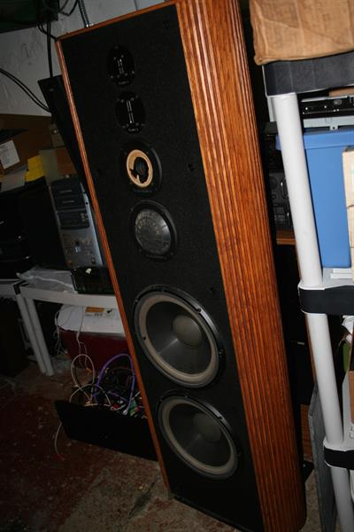

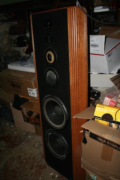

kve777 6,897 Posted February 22, 2015 Author Posted February 22, 2015 Thursday came and went. When are you bringing those damn things in the house so we can take a look see with the grilles off? I dragged 'em in and they are in the basement. It's crowded down there. But here goes- The woofer surrounds will be easy. The Polygraphs, not so much. I went to remove one- damn! The solder the spade connections! Once I get them off, I have a plan. It includes a couple of woofer dust caps that have the exact size and shape needed. The surround roll will be the most delicate. I will reinforce and repair them with RTV. I shall document with photos. 1
Gene C 1,753 Posted February 22, 2015 Posted February 22, 2015 Yeah, a de-soldering iron is very handy with those speakers. The first time seeing those terminals soldered I was like WTF?
kve777 6,897 Posted February 22, 2015 Author Posted February 22, 2015 Yeah, a de-soldering iron is very handy with those speakers. The first time seeing those terminals soldered I was like WTF? I might cut them and solder connections a few inches away, just to avoid overheating the VC leads. A real concern considering the amount of solder I see. Are all of the connections like that? I have to pull six drivers.
Gene C 1,753 Posted February 22, 2015 Posted February 22, 2015 Yes, every one of them have spades connected with solder. You will be fine as long as you are not on those terminals for more than 5 seconds. I did a few passes with some wick and pulled the connections off with the iron on it after getting most of the solder off. Once you get them back together you'll want to re-solder those spade connections. 1
