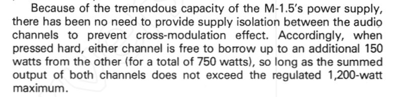

zumbini 6,150 Posted February 21, 2016 Posted February 21, 2016 ....This may be a dumb question but rather than get the 45, why wouldn't you pick up another TFM-25 and run them bridged? Seems like it would sound great and look cooler to boot!.... There are no dumb questions Billy. (At least that's what I keep telling myself. ) Bridging tends to reduce or smear the soundstage (your mental picture of where the instruments/voices are located). It can also affect how well an amp controls speaker cone excursion which may result in "flabby" (less focused) bass. If you need more power try single channel mode (feed signal to 1 amp channel of each amp; each amp drives 1 speaker). This is called "power steering" and it applies to most common ground amps. Here's an excerpt from the M-1.5t manual:
