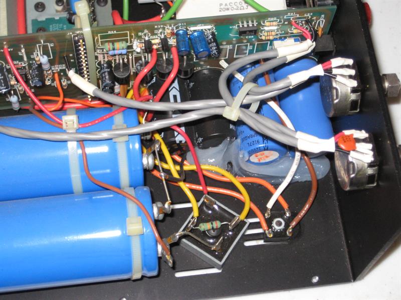

morris 390 Posted August 26, 2016 Posted August 26, 2016 loner_t asked me to look inside my NASA TFM42 to see how the volume pots are wired. Note the ground wire is red. 2
fill35U 1,848 Posted August 26, 2016 Posted August 26, 2016 loner_t asked me to look inside my NASA TFM42 to see how the volume pots are wired. Note the ground wire is red. Thanks for the diagram and pic, Morris! According to your diagram, that's an unusual way of doing it! Typically, the pot wiper is connected to the *downstream* side of the signal path. With the wiper connected to the input side like this, when the volume is turned all the way down, the input is shunted to ground, presenting a dead short to the source. A typical source might have an output impedance of around 200 to 1200 ohms. Hopefully the intended source is designed to not mind having its output shorted for long periods of time... As the amp's level pot approaches the source's output impedance, the voltage from the source will drop, making the level control effectively more nonlinear at the quiet end. At the same time, with the amp's level turned all the way down, the pot presents a high impedance to the amp input, which means it could be noisy when it should be quietest. Are you *sure* that's how they did it? They moved the shunt cap for the left input to the new pot, and used its board holes for the wires to the level control. Did anybody notice they put the left level control on the *right* side of the amp, and the right level control on the *left* side? And who uses red for ground, and black for signal?? NASA...
morris 390 Posted August 26, 2016 Posted August 26, 2016 Are you *sure* that's how they did it? Perhaps it was like this? 2
fill35U 1,848 Posted August 26, 2016 Posted August 26, 2016 Are you *sure* that's how they did it? Perhaps it was like this? Yeah, that would be the way the rest of the world does it. 1
