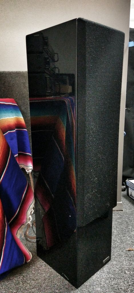

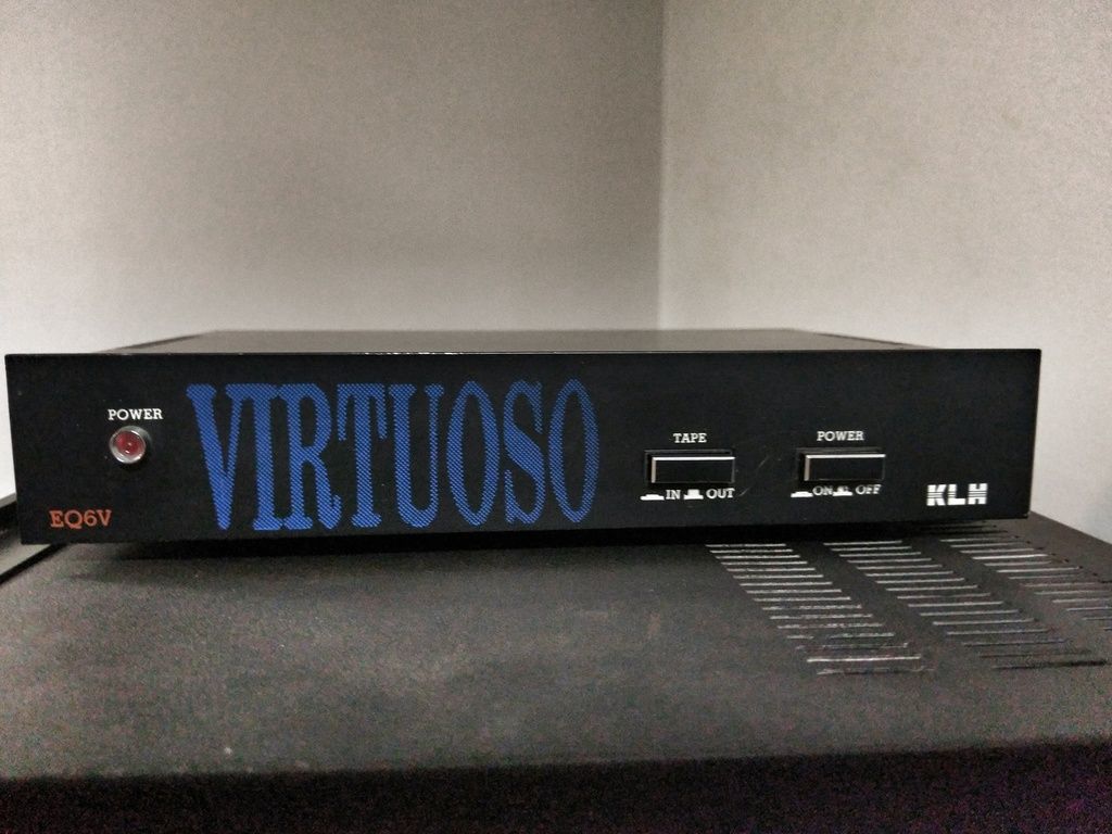

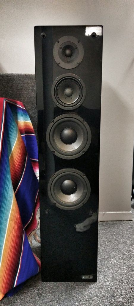

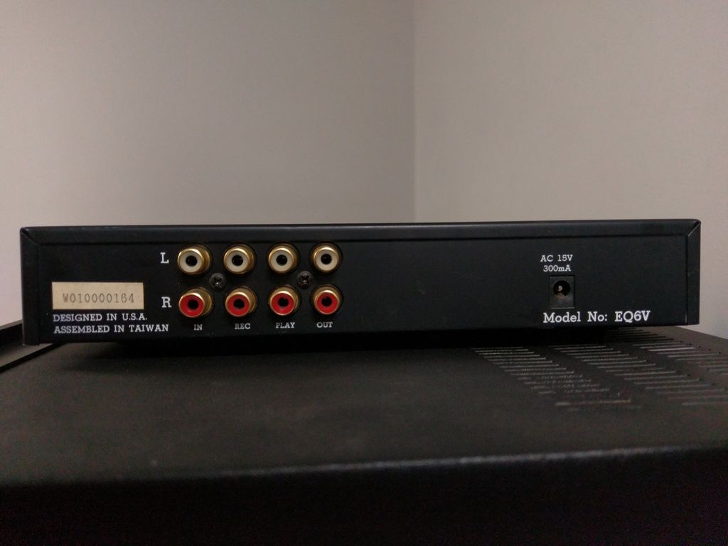

Vin 6 Posted October 13, 2016 Author Posted October 13, 2016 So the guy with the c-11 still has it, but is getting back to me later. I think I should listen to the experience here and go with that one. (I'm not going to lie, just going by appearance it looks like a step down but I'm a new and don't really need all the fancy digital stuff) In the meantime here are a couple bad low light pics of my klh virtuoso 6v speakers. I can't really find much info on them. They also came with this box, not sure if I need it or even what it does lol. 1

zumbini 6,154 Posted October 14, 2016 Posted October 14, 2016 ....In the meantime here are a couple bad low light pics of my klh virtuoso 6v speakers. I can't really find much info on them. They also came with this box, not sure if I need it or even what it does lol. According to my research the Virtuoso 6V was manufactured in 1991. It has a 1" dome tweeter, 4.5" midrange, and two 6.5" woofers. Frequency response - 29hz-29khz +/- 3db. Sensitivity - 88db. MSRP - $1550 per pair. The "box" (EQ6V) appears to be an equalizer designed to be placed in a tape/processor loop. Typically speakers sold with an EQ sound weak at one or both frequency extremes when used without the 'black box'. 2
