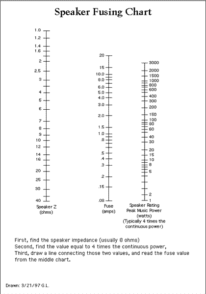

zumbini 6,153 Posted August 28, 2017 Posted August 28, 2017 Good plan. Fuses are cheaper than drivers... For fuse sizing I start by contacting the speaker manufacturer for a recommendation. If that's not possible, or the OEM won't help, you can estimate the size using this chart: As to whether to use a time delay or fast acting fuse, that depends on the application. If the expected failure mode is due to excessive cone excursion I use fast acting. If the concern is overheating the voice coil a time delay fuse is more appropriate. In either case I start with a fuse smaller than what is recommended and work my way up. 14 1
