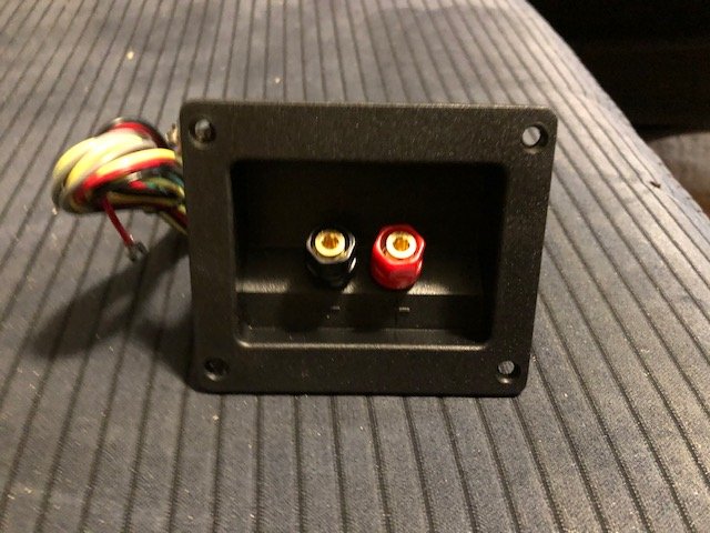

Will Meyer 2,479 Posted May 2, 2020 Posted May 2, 2020 (edited) I have a real fondness for speakers - I really like tinkering with them. I typically look over Craigslist and pick up speakers needing a little TLC. My latest acquisition was a pristine looking set of Advent Prodigies (these are 8inch 2 ways) that I paid $35. The speakers needed refoaming but I've done over 2 dozen of these Advents - easy. I like Advents - they use nice cabinetry and good drivers. Advent went real cheap on the crossover and sound insulation and these speakers benefit with a little attention in these areas. Updating the caps to metalized polypropylene and adding additional sound insulation improves the sound quality significantly without adding significant cost. I also planned on trying some updated inductors on this set. Wherever possible, I also update the terminal block with 5 way binding posts. My surprise when I pulled the speaker apart was that both pair had total blown crossovers. 13uF capacitor had grenaded - possibly my experience is limited and this is common but I've never seen this in a speaker. While the crossovers were toast the drivers test fine - I completed the refoaming on the woofers yesterday. Here is a pic of the blown (and cheap) crossover I pulled out the Prodigy. I also included a pic of the blown crossover next to the built up replacement mounted on a new terminal block. The new crossover is using Solen caps and new inductors. I've maintained the same basic circuitry with upgraded components. I don't understand how someone can do this to a speaker. I'll finish these tonight. Next I'm looking at a Cerwin-Vega AT-8 that needs reconing. Edited May 2, 2020 by Will Meyer 1 5

4krow 7,945 Posted May 2, 2020 Posted May 2, 2020 Nah, I have never seen this in a circuit, period. Seeing how this has already occured, it is a good time to make better terminations for the speaker binding posts. I can imagine how crappy the originals were. They practically all were back then. 2 1
Will Meyer 2,479 Posted May 2, 2020 Author Posted May 2, 2020 (edited) Agreed - the original binding posts were pretty poor. I picked these up off Parts Express on closeout for $2.75. Its a complete crossover. I strip rhe components. I unwound the inductors to get 200 and 300uH as required for these Advents. I use the 5 way binding posts to upgrade my speakers. I used these binding posts on a set of my JBLs and 2 sets of Advents. They worked out really well. Btw... An enterprising individual is buying these from P-E for $2.75 each and reselling them on ebay for $16. Easy money. Edited May 2, 2020 by Will Meyer 7

4krow 7,945 Posted May 2, 2020 Posted May 2, 2020 Will, i think that you did a fine upgrade. You didn't go over the top either in price or quality. The upgrade/repair matches the need very well. I am also amazed at how little went into most speakers back in the day. Adding a bit of damping material, and sometimes even another brace where there was none can be a worthwhile improvement. A friend of mine has the same fascination for many vintage audio equipment. I enjoy looking it all over and seeing what was done back in the day. 2
