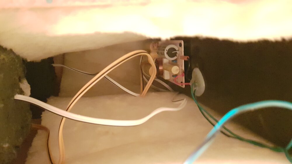

maskinisten 59 Posted December 4, 2021 Author Posted December 4, 2021 Update, i removed the woofer and gave it a thorough check again. Everything seems solid and well glued together, i also connected the woofer outside the cabinet and played a test tone through it, at least i now know for sure that its the driver itself making noise. I also took a few pictures 1
