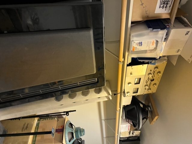

Ar9Jim 6,520 Posted October 10, 2023 Author Posted October 10, 2023 (edited) Here is a peak inside one of Bob's many closets at the lab house. He has another closet mostly filled with a huge transformer collection. Here is a portion of his vacuum tube collection and a couple spare Harmon Kardon Citations designed by Stu Hegeman. Bob said "the matching preamp is just ok, but Stu's amp was really nice." Bob thinks highly of Stu Hegeman. Sorry the pics are sideways. Edited October 10, 2023 by Ar9Jim 3 2 3

ChrisTFM35 670 Posted October 10, 2023 Posted October 10, 2023 Jim, How about a pic of the Phase Linear gear on that top shelf? Chris 3
Ar9Jim 6,520 Posted October 11, 2023 Author Posted October 11, 2023 11 hours ago, ChrisTFM35 said: Jim, How about a pic of the Phase Linear gear on that top shelf? Chris Hi Chris, I'll be back out to WA next year. That's the only picture I have . 3
