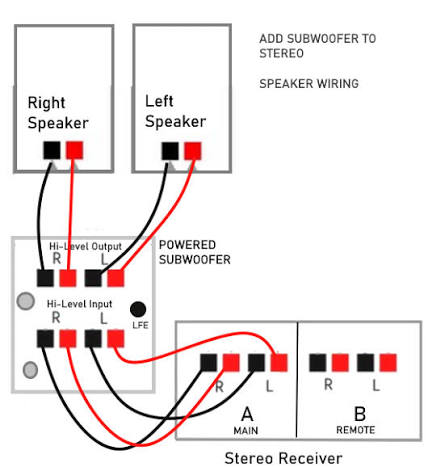

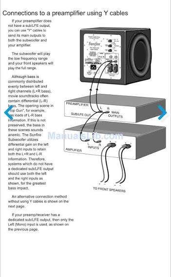

Community Admin AndrewJohn 11,725 Posted July 18 Community Admin Posted July 18 i should add, also, that I'm assuming that your subwoofer is a powered subwoofer (has an internal plate amp). here's a diagram for a SPEAKER LEVEL or often called HIGH LEVEL method of connecting a subwoofer to the speaker outputs on your receiver. For a y-cable, using the PRE-OUTS, the best diagram I could come up with on the internet is this one..., (again, a better one might be in your subwoofer manual.) but in this figure, consider that the y cable would be in the Preamplifier... 3

Ray Cole 10 Posted July 18 Author Posted July 18 16 minutes ago, AndrewJohn said: i should add, also, that I'm assuming that your subwoofer is a powered subwoofer (has an internal plate amp). here's a diagram for a SPEAKER LEVEL or often called HIGH LEVEL method of connecting a subwoofer to the speaker outputs on your receiver. For a y-cable, using the PRE-OUTS, the best diagram I could come up with on the internet is this one..., (again, a better one might be in your subwoofer manual.) but in this figure, consider that the y cable would be in the Preamplifier... Thanks Andrew! A y-cable might be just the thing. My sub has no speaker-level inputs, so that top diagram won't work in my case, but an RCA Y-cable might. 1

Community Admin AndrewJohn 11,725 Posted July 18 Community Admin Posted July 18 @Ray Cole, your owners manual is still available on Crutchfield.com in the drop-down for "What's in the Box" on the page you shared. Here's the direct link to the PDF of the owner's manual. https://pdf.crutchfieldonline.com/ImageBank/v20060406130800/Manuals/602/602SUS100B.PDF It includes diagrams. And from the specs, I see it only accepts LINE LEVEL (or LOW LEVEL) input - NOT speaker level - so you want to get an RCA Y-cable to split the pre-out, one "y" goes goes directly back into where the U-Jumper pulled out of, and the other "Y" goes to the RCA input of your sub. Examine the last diagram on page 5. You'll want to consider (map out) the female, mail connections for the Y cable, and for the joining cable to the sub. But from here you should be good to go - and yes, sketching it out helps before you buy a bunch of y-cables and RCA cables on Amazon... Hope that helps you. 2
