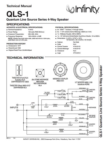

Ratamahatta 437 Posted March 24, 2013 Posted March 24, 2013 I took a much needed break from audio but after a hiatus I am back with some Infinity Quantum line source speakers. There is a high end audio shop nearby in Ft Collins CO. I went there just to look but when I saw these I was interested and after I listened I knew I had to have them. They are in excellent condition, and all the drivers work, The shop owner re foamed the Watkins woofers and cleaned them up, they sound excellent but I know replacing the old caps and resistors will help them sound even better. I also listened to some Vandersteen model 7 speakers truly outstanding but to rich for my blood. Anyone in the northern CO area should check them out http://www.audioalternative.com/ . I plan on either using Dayton 1% or Clarity cap PX on these and have to use 25w resistors from Madisound. Anyone have any experience with these? So far I am really impressed with these the vocals seem to cut right through your ears and play directly to your brain, everything sounds so natural.

zumbini 6,154 Posted March 24, 2013 Posted March 24, 2013 Infinity recommended a minimum of 100 watts but did not specify a maximum rating.

Ratamahatta 437 Posted March 24, 2013 Author Posted March 24, 2013 Very nice looking speakers:-) are they power hungry? What are you feeding them with? Thanks, Yeah a little bit, the Watkins dual VC with different impedance woofer with 1100uf and 1400uf caps soak up a bunch. I Am powering them with a Rotel 990BX, should be 320 rms into a 4 ohm load. I am going to get a cap tester but know after 35 years these would probably benefit on a cap and resistor upgrade.

Ratamahatta 437 Posted March 25, 2013 Author Posted March 25, 2013 I was thinking either Dayton 1% for the mids and highs or Clarity cap PX. I am leaning more towards Clarity though. I have used Dayton caps in the past with good results but have to say I think Clarity caps are a notch higher, any thoughts? I want to get a meter because if I don't have to I would like not to replace the caps on the woofer, they are some huge electrolytic caps and people that have replaced them have complained of weak bass response afterwards. Not my photos.

galaxyoilcan 88 Posted April 1, 2013 Posted April 1, 2013 These QLS-1 look fantastic! I share your enthusiasm for them and have a wall of vintage speakers with a collection of Infinity Quantum speakers that range from an unfinished rebuild of a pair of QLS-1, to working pairs of Quantum 2, 3 and 5 models. I also have a working pair of Qb's with the same cool metal stands as I have for the Quantum 5's. I either need to complete the collection or start selling it off. You are absolutely correct about the Watkins dual voice coil woofers being the power hogs. They are designed to trade adequate power for accurate bass response as low as you care to go. Line array rules! I can't wait to see more on your QLS-1 rebuild project. Maybe it will help me figure out how to finish mine. I wonder if there are any crossover mods or upgrades that Infinity fans have come up with over the years? 1
Gene C 1,753 Posted April 1, 2013 Posted April 1, 2013 Well I got it in and it seems to work fine it powered right up out of the box, its funny how all my old Polk caps were not that far off. I will test it on whatever new caps I get. I will start a new thread in the speaker modification thread on the re-capping of these. Thats not surprising. What I've recently learned is that some eletrolytics in speakers are underrated by 20% so that when they age the values will stay somewhat intact. And as well they are not prone to leak like the caps we replace in our amps. Glad your happy with your capacitor tester. 1
