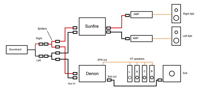

shoesteve 6 Posted August 8, 2013 Author Posted August 8, 2013 to clarify i have the sub hooked up to my denon currently and its working fine...i use the denon for watching movies......simply i wanted to plug the sub into the sunfire theater grand processor....to see how it sounds with my music in 2 channel....when i plug it into the rca sub connects i get nothing....i dont know why....anyways i figured id run it using speaker wire to my speakers but cnt find anything when bi amping.

Nahash5150 10,776 Posted August 9, 2013 Posted August 9, 2013 So let me guess... You have you computer connected to the Sunfire (music), and your DVD player (movies) to the Denon right? Why not run an optical TOSLINK from your computer to the Denon? Then you can connect your L & R pre-out to your Sunfire and use us it for everything and allow your Denon to do what it does best and manage all ins and outs.
shoesteve 6 Posted August 9, 2013 Author Posted August 9, 2013 i connect both the denon and the sunfire with a cable that on one end has left and right rca and the other is a microhone jack...i swap them when i want to listen to music i siply pull out the one from the denon..i do not watch dvd's and i dont play cd's i have 2 TB's of music and movies on my storage drives in my pc.....i do not want to run the sunfire all the time. id like to keep it as long as possible so im trying not to "wear it out" sometimes i fall asleep watching movies and i dont want the sunfire getting all that use.. the denon im very happy with but i can get another much easier than the theater grand...
Nahash5150 10,776 Posted August 9, 2013 Posted August 9, 2013 Then just get an RCA Y splitter and run into the sunfire AND the Denon (aux in). Then when you want to hear the sub, you just select AUX (or whatever RCA input you use on the Denon) and you'll get the SUB pre-out to work with the same signal going to the Sunfire.

shoesteve 6 Posted August 10, 2013 Author Posted August 10, 2013 thank you hashy i bought the connector and i have the denon on in aux with the sub connected to the aux and turned the speakers off and im getting the sub to function......now im gonna see if i can turn the sunfire/carver system off and play my movies through my computer with out having to un plug anything....brb....back...ok so when i turn the sunfire/ carver off and just use the denon my front/ center/ surround speakers work but not the sub...i can deal with that...all i have to do is change the rca connected to the aux and place it into the sub jack...no biggie....and thanks to rich for the advice on the Electrolytic capacitors....once again problem solved by The Carver Site
