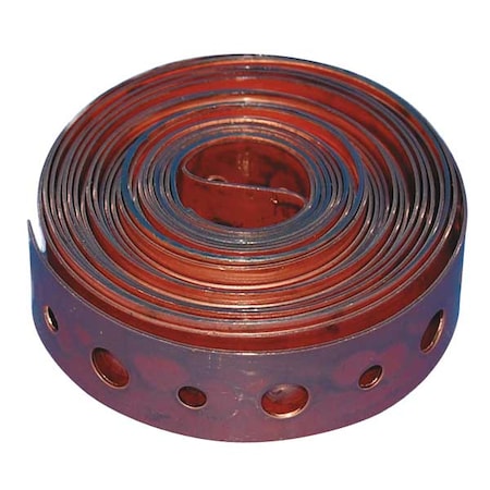

kve777 6,911 Posted July 8, 2014 Posted July 8, 2014 I've used that perforated copper strapping for suspending copper pipe in plumbing. Easy to notch out with wire cutters.
