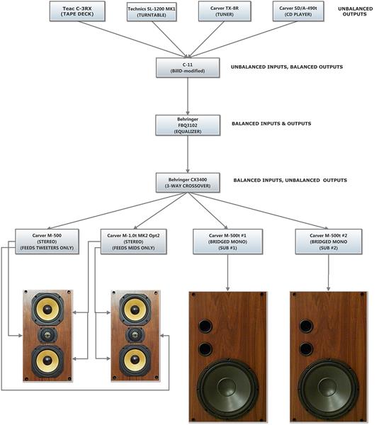

hammytech 51 Posted March 9, 2015 Posted March 9, 2015 There is Bi-Amping, which is awesome, and recommended... and then there is Tri-Amping. Example. 2
zumbini 6,154 Posted March 9, 2015 Posted March 9, 2015 I'm using 4 amps to drive 3 frequency bands. Am I quad-amping or tri-amping?
Ar9Jim 6,609 Posted March 9, 2015 Author Posted March 9, 2015 That a nice high powered system Dom!Did you setup the sound when you and your brother worked at Cosmic lights?Quad-amp 3 way system sounds accurate?
TNRabbit 371 Posted March 9, 2015 Posted March 9, 2015 Assuming the subs share the same frequency range, you are tri-amping. 2
