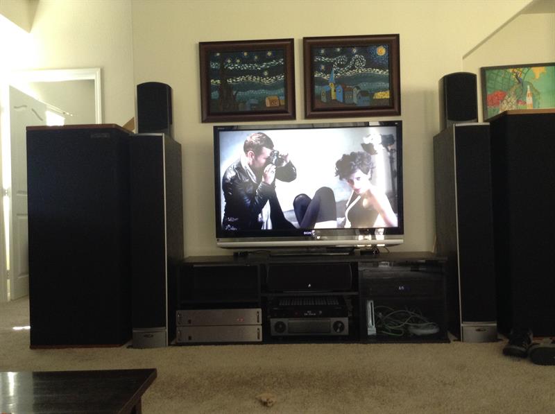

BillyDef 4 Posted May 2, 2015 Author Posted May 2, 2015 Ok, all setup. I ave been doing some tests between the RTI12 and the SDA SRS2. I like the sound much better from the SRS speakers. THe RTI12 sound a bit shrill at higher volume levels where the SRS are much more smooth. I also like the sound of the M4.0t (unmodified) over the M1.0t (unmodified) so far. I'm wondering if I could retrofit or make bookshelf speakers from the SRS woofers and tweeters to make a much more WAF friendly setup. I am going to end up moving them into a different room. Here is a picture: The video is Kaskade - "Fire in your new shoes" on youtube streamed through Apple TV.
RichP714 3,169 Posted May 2, 2015 Posted May 2, 2015 ..... I'm wondering if I could retrofit or make bookshelf speakers from the SRS woofers and tweeters.... Polk did that for you already:
BillyDef 4 Posted May 2, 2015 Author Posted May 2, 2015 Thanks, i was looking at those but still thinking I would like something a little more modern looking. Also, I don't need SDA with a 9.2 channel source. I'm guessing surround sound or 5.1 was what killed SDA. The bookshelf speakers on top are Aperion and supposed to be pretty good. They don't sound as smooth and full though at medium to high volume. They are front presence speakers for now. I might return them at the end of the free in home trial.
Bean 384 Posted May 3, 2015 Posted May 3, 2015 I know a couple folks running SDAs w HT so you can keep em. Please don't cut em up, sell them instead. I could prob help you Find a buyer for em too. Anyway glad your liking them.
Nahash5150 10,997 Posted May 3, 2015 Posted May 3, 2015 The video is Kaskade - "Fire in your new shoes" on youtube streamed through Apple TV. I like it.
