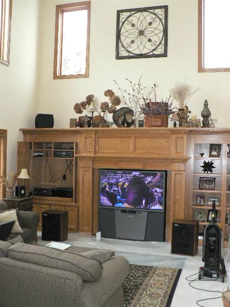

emmjlm 5 Posted March 7, 2010 Posted March 7, 2010 Sorry for the dirty room, I'm oiling my speakers, my daughter is doing homework, and we are listening to her pick of music. You can see the sub in the top left of the mantle. Yes, the WAF is not high on this arrangement, but I'm here to confirm, it works VERY well. Originally the fu-fu on the mantle was on the two sides, if I can get it back over there it would hide the sub quite nicely.
