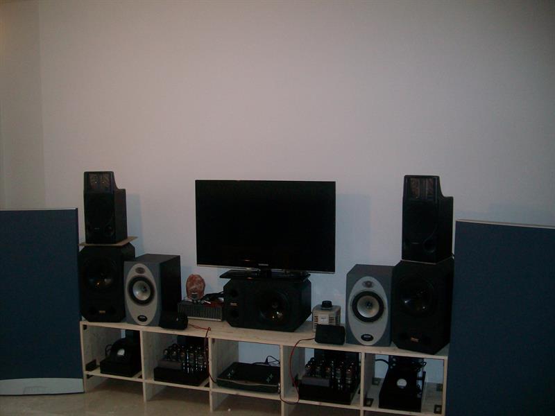

ABilluminazione 4 Posted November 11, 2016 Author Posted November 11, 2016 Hi everybody, to Reese: thank you for your kind words, but Italy is a land of big contraddictions... At last, these are firsts pics of the double-face game field: for inhabitants under 3 years old and for over 50 years old. This is still a work in progress, the wood furniture is just a visible example for the eyes of who-will-decide (not me, of course), and I did not hook the silver7's up to the variac. 4
PMAT 2,066 Posted November 11, 2016 Posted November 11, 2016 Hot dang! The mother ship. Please do some close-up photos. Thanks
