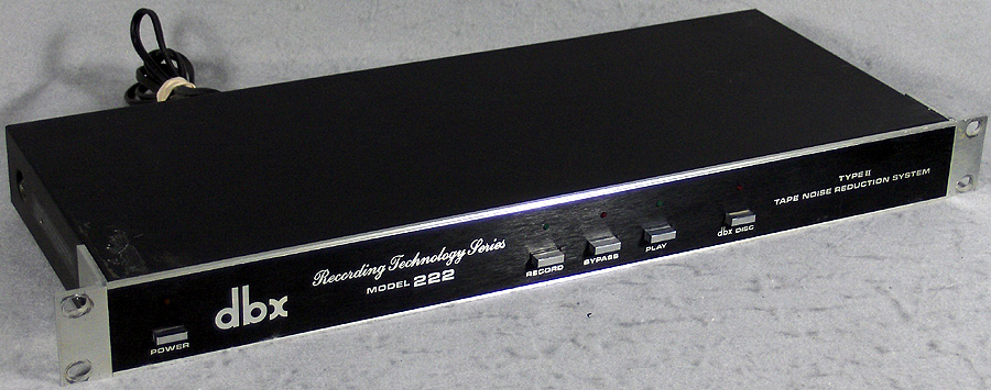

When looking for a decoder a model 222 or 224 will decode discs as well as offer tape encode/decode.
I have seen the 222 sell for under $20

I have just learned about the records being "DBX encoded".  I didn't realize they made them.  I am going to try them out.  I just bought a DBX 222 from Ebay for $29.00.  I have always had a Yamaha DBX cassette deck (K-2000) in the house and at one time had a DBX Alpine car stereo (mid 80's).  Never had an DBX standalone unit, until now.  I like the technology and it's another toy to play with.........grin

Here's a fairly complete list of DBX units that will decode DBX-encoded LPs:
DBX II Model 122
DBX II Model 128
DBX Model 140 (barrier strip connections only)
DBX Model 222
DBX Model 224
DBX Model 224x
DBX Model 228
DBX Model NX-40
