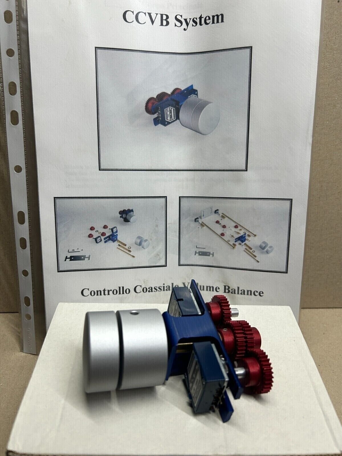

4krow 6,605 Posted December 7, 2023 Posted December 7, 2023 It's something how a balance control can be a thread in its own right. I wasn't aware of the issues until I decided to put a balance control in one of my units. In my next build I am going with the stacked volume pots (well, not physically stacked, but you get my meaning), as that solves the balance control issue in an elegant way. 3
