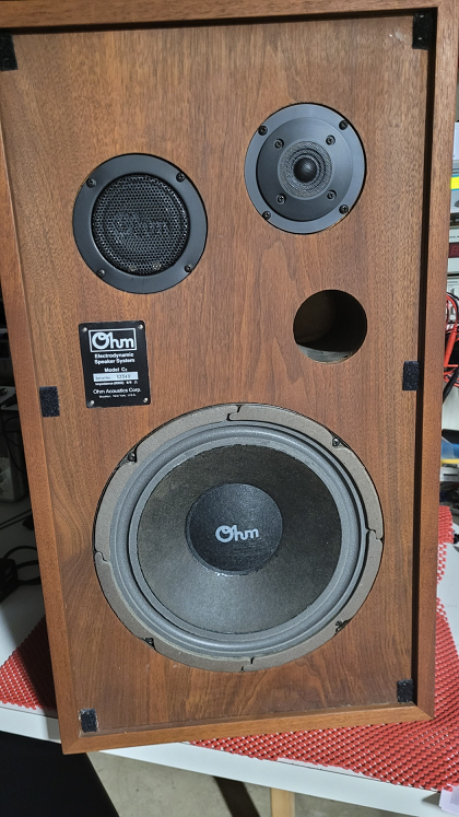

3M_Audio 2,549 Posted January 17, 2025 Posted January 17, 2025 Had a good friend from our church that knows I run a speaker manufacturing business, so he asked me to help him with his stereo system which he described as 'sounding thin'. He had a nice silver-faced Onkyo receiver and some beautiful Ohm C2 speakers. The C2s are a 10" ported design and were marketed by Ohm as a bookshelf speaker. After about 2 seconds of listening, I told him what the problem was. I'll probably service the crossover at the same time I have the woofer out. Should be a fun project. I have listened to these before and they have a nice, warm sound. Not the best imaging, but OK. They need lots of power. 7 2
BobTFM35 3,439 Posted January 17, 2025 Posted January 17, 2025 It looks VERY free floating. I would think with new foam or rubber surrounds plus new modern caps it will sound much better. Looks like a fun project!! 3
3M_Audio 2,549 Posted January 17, 2025 Author Posted January 17, 2025 Just now, BobTFM35 said: It looks VERY free floating. I would think with new foam or rubber surrounds plus new modern caps it will sound much better. Looks like a fun project!! It's surprising how many speaker owners never remove the grills from their speakers. The guy that owns these bought them new in 1979 and he never was curious enough to take a look. These are fun to do although to do it right, all the old adhesive needs to be removed from the basket before installing the new surround. These use an inverted foam surround. Quality replacements and adhesives are available from Springfield Speaker - a good small company. My friend was interested in the process, so I'm planning to shoot a video of this one. I'll post a link here once finished. 5 2 1
BobTFM35 3,439 Posted January 17, 2025 Posted January 17, 2025 I had a set of speakers that I bought when I was in Japan. For all the places they traveled and the action they endured they looked pretty good when I took them out of the cabinet for the first time in their life. The recapping gave them a new life as I'm sure it will do the same for his set. 2 1

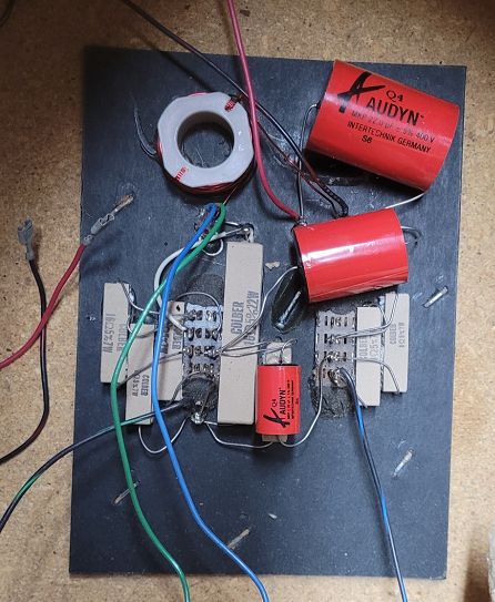

3M_Audio 2,549 Posted January 23, 2025 Author Posted January 23, 2025 (edited) For any of you following along. My friend decided to have me replace the (3) caps in the crossover so that's done: And the new surround is glued into place. Most of the work is scraping off the old adhesive on the basket frame - it has to be perfectly clean. I find that with most of these speakers from the late 70s and onward, the spider holds the voice coil into proper position with only very minor positioning required, so shimming isn't necessary. Edited January 23, 2025 by 3M_Audio typos 5 3
Community Admin AndrewJohn 11,668 Posted January 23, 2025 Community Admin Posted January 23, 2025 4 hours ago, 3M_Audio said: For any of you following along. My friend decided to have me replace the (3) caps in the crossover so that's done: And the new surround is glued into place. Most of the work is scraping off the old adhesive on the basket frame - it has to be perfectly clean. I find that with most of these speakers from the late 70s and onward, the spider holds the voice coil into proper position with only very minor positioning required, so shimming isn't necessary. Where do you get those clamps?
BobTFM35 3,439 Posted January 23, 2025 Posted January 23, 2025 Harbor freight? https://www.harborfreight.com/hand-tools/clamps-vises/spring-clamps/spring-clamp-set-22-piece-69374.html 4
3M_Audio 2,549 Posted January 23, 2025 Author Posted January 23, 2025 2 hours ago, BobTFM35 said: Harbor freight? https://www.harborfreight.com/hand-tools/clamps-vises/spring-clamps/spring-clamp-set-22-piece-69374.html Bing! 3 1
3M_Audio 2,549 Posted January 24, 2025 Author Posted January 24, 2025 Finished and sounds pretty nice. Beautiful cabinets - real walnut veneer even behind the grill cloth. I think if these were mine, I'd leave the grills off and remove the velcro. I'll shoot some video of the second speakers to share. Owner has me doing one at a time so he can still listen to something 6 1
