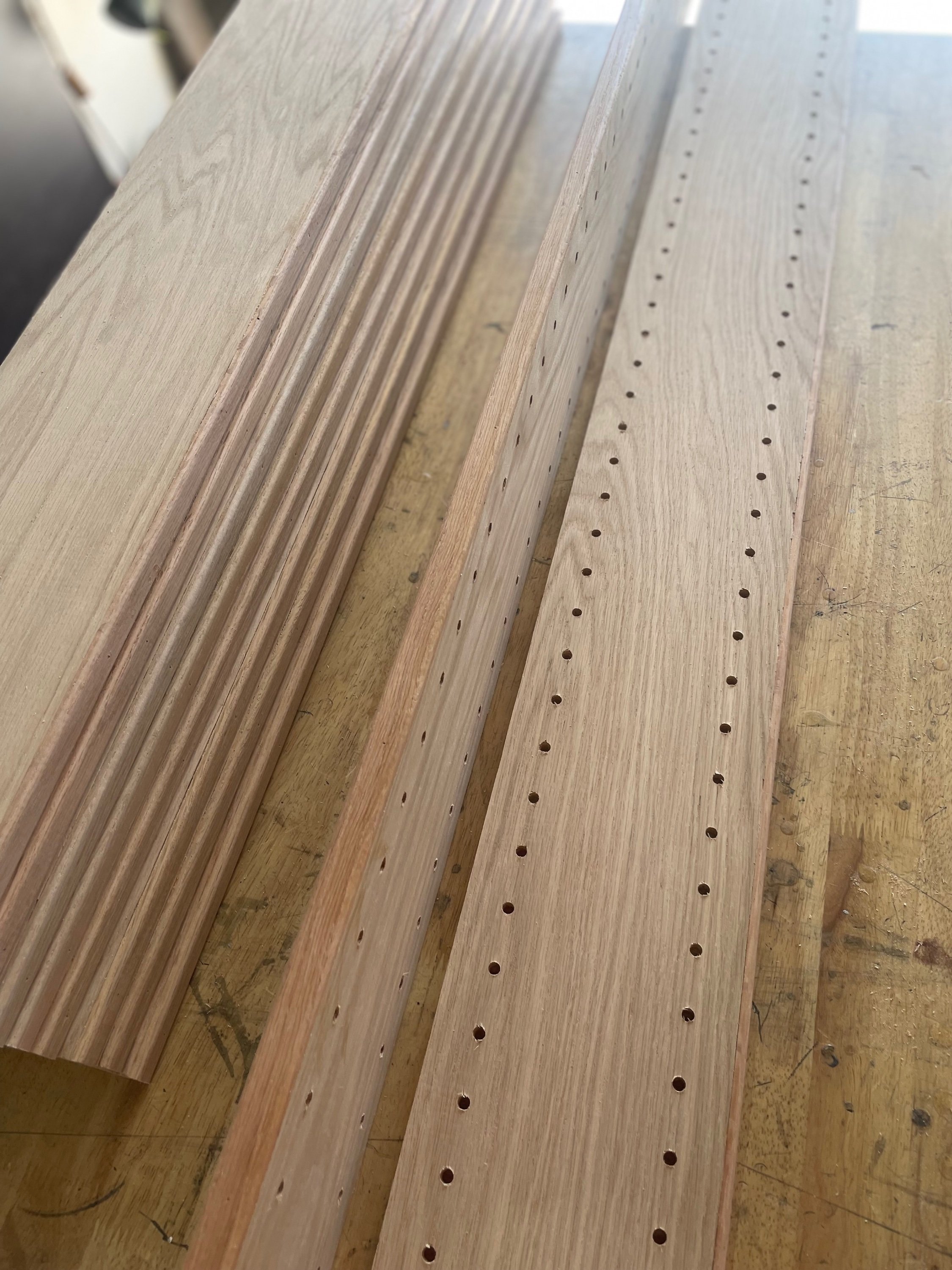

Next, cut 2 (or more) of the strips to the overall height you desire for your shelving unit - in my case, for this unit I’m going with 60” (Al the other shelving in my room is 96”, or the full 8’).  These will be the vertical or side supports.  In order to make the shelving fully adjustable, these need to have a series of holes drilled for the shelf support pegs.  These hole need to be perfectly spaced, drilled perfectly perpendicular, and be  a perfect consistent depth on BOTH boards.  Luckily, Kreg makes a jig for this that is quite affordable and easy to use…

Work these two strips together and symmetrically, so that your shelves will be level.  I mark the top of each, and start my holes at the exact same height.  The bit included with the jig has an adjustable stop collar - set it to the correct depth and drill the starter hole at the top.  Then position the jig with the included pin and drip the remaining holes.  Move the jig down, place the pin and repeat.  It’s not near as monotonous as it sounds, and it goes pretty fast.
