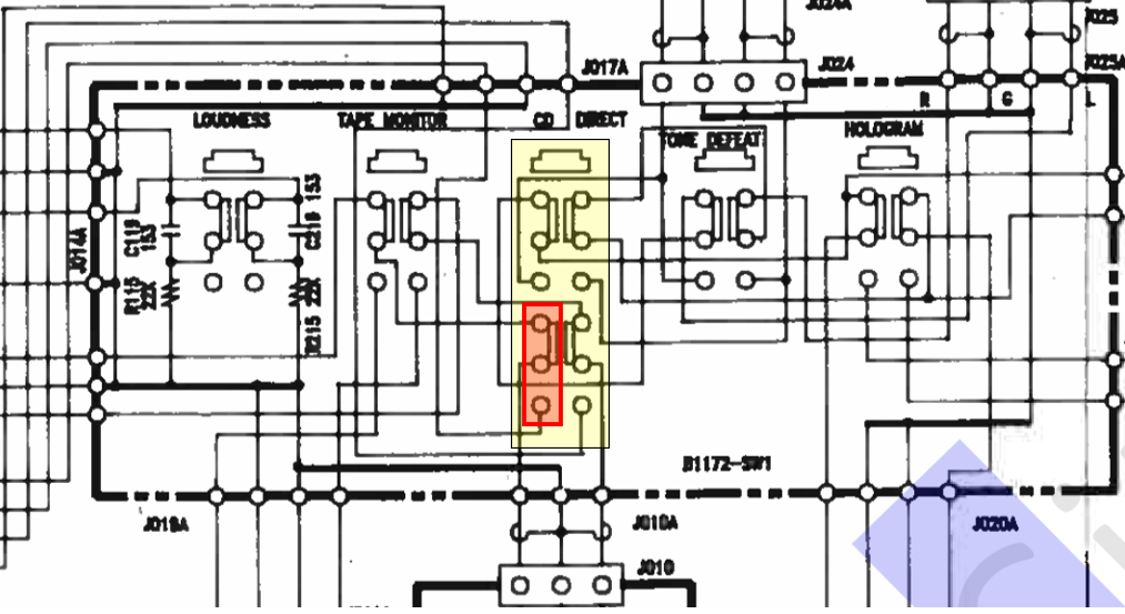

Beetle1303 9 Posted February 1 Author Posted February 1 It seems quite impossible to de-solder and remove just one such switch, but need to de-solder all 5 switches off the board. Then remove the metal faceplate with 4 claws clamped onto each switch... But, before attempting to de-solder all of them, I checked all the switch on contact/continuity with DMM. All tested OK, except for this CD Direct 12-pin switch. The bottom left 3 pins all "shorted" - looks unlikely to be the switch internally shorted, and more likely somewhere shorted in the circuit path. But I am completely lost in trying to trace with a "blurry" schematics... Anyone with better experience with schematics (and eyesight) can see where is the potential short(s)? 1

Beetle1303 9 Posted February 3 Author Posted February 3 On 2/2/2026 at 12:23 AM, BobTFM35 said: No direct knowledge of this piece of equipment. Just a other set of eyes for support and a suggestion. Have you used the block diagram on page 7 of the manual? It might give a better logic flow and give some support to the schematic. Yes, the block diagram on page 7 is much simpler to understand to trace. Unfortunately, no luck and couldn't find anything that seems to be shorted. Perhaps indeed something shorted within that 12-pin switch... Too much pain to get it off the board... 1
