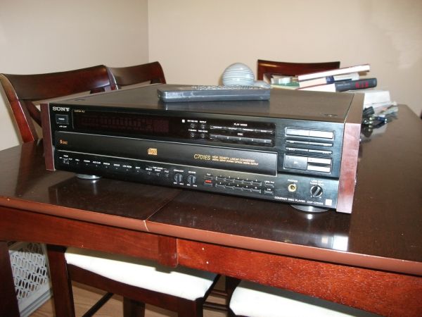

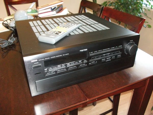

Audioquest 8 Posted October 9, 2010 Author Posted October 9, 2010 The fellow also threw in a mint Sony CDP-C701ES 5 disc changer with rosewood side panels, and a mint Yamaha RX-V1070 receiver. Also included a 10' pair of factory terminated 12 ga. Monster cable. I'm currently listening to the CDP on my 2 channel Platinum's system and it sounds pretty amazing.

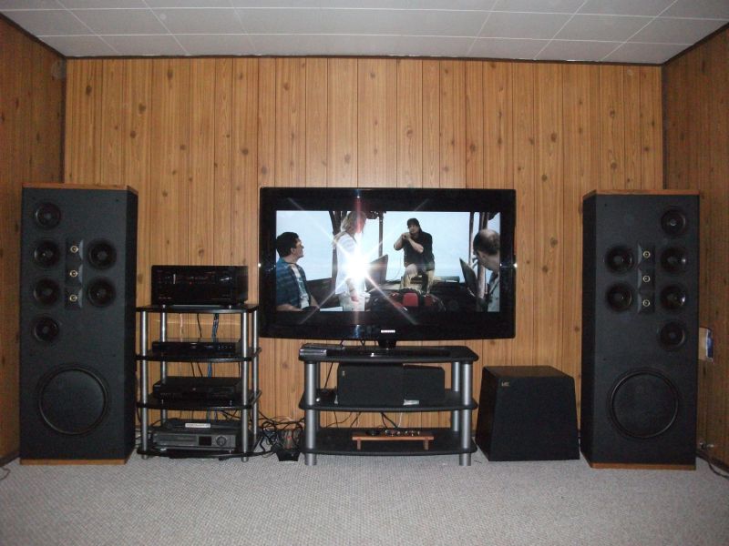

Audioquest 8 Posted October 10, 2010 Author Posted October 10, 2010 Ok, here is a preliminary shot of today's score. Ignore the "nice" wood panel walls as that is the winter project to yet be dry-walled. Anyway the room as about 14' wide by 23' long. I plan on moving the components to the rear or side wall once I get a longer HDMI cable as these monsters take up a lot more space than my previous speakers. Difficult to say how they compare to the Platinums as an A/B comparison would be difficult as both systems are on different floors. My brother lent me the newest Rambo movie as I never did see it. These Polks have a lot of impact paired with the 2 M&K subs. I set up the receiver to not have a center channel and it really doesn't leave any audible hole with only the 2 Polks up front so ignore the MK laying on it's side below the LCD
Ratamahatta 437 Posted October 10, 2010 Posted October 10, 2010 if possible you should set up along the long wall, sda's usually require 3 feet on the sides to prevent reflections getting to your ears before the source of the dimensional drivers, if not possible room treatments on the wall next to the speaker will usually do the trick.
zumbini 6,154 Posted October 10, 2010 Posted October 10, 2010 weitrhino is correct. The line of 4 mids should be on the inside, closest to the opposite speaker. The other pair of mids is responsible for the "dimensional array" effect. Speaking of the dimensional array", do you have the interconnect cable that runs from one speaker to the other?
Ratamahatta 437 Posted October 10, 2010 Posted October 10, 2010 Aren't they flip-flopped? no, the 2.3tl's set up opposite. The tl's came out after these and have 4 stereo drivers and 2 dimensional. These are the regular 2.3's 2 stereo 2 dimensional and 2 subs the subs go to the outside. I have both.
