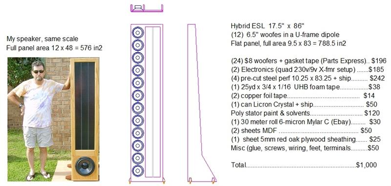

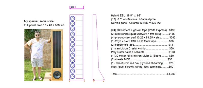

jazzman53 1,302 Posted April 29, 2012 Posted April 29, 2012 To me, electrostats in general don't have the "impact" of other speakers. Plus, they are prohibitively expensive. I think you can get as good imaging (their strong suite) with a lot less money. I have yet to find anything in the budget of my AL-IIIs that come close to the imaging & realism. I've heard some fantastic ML systems, but the cost is just so out there. Now, if I won last nights $640 million Powerball lottery, I would be calling Bob right now to order a pair of his new ALS speakers...damn the cost! Mmmmmmmmm.... generally, all that's true, but most commercial ESL's are pretty much pussies anyhow. Bob's ALS's blew me away at the AXPONA show... can't afford 'em of course but they got me daydreaming about a cheap line source ESL with real SLAM-- one with a curved panel for wider sweet spot, the second with a flat panel for max dynamics and imaging:
