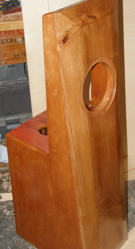

4krow 7,943 Posted January 7, 2013 Posted January 7, 2013 Finally! Not the best file, but at least it worked. Now this is the OB speaker that I was referring to. The design is from Decware, and uses a cavity to produce bass. It is tuned to about 40hz, but the is adjusted to cover a wider range. As an experimentor, This next photo is using the baffle upside down, using the cavity actively. In that application, An Audio Nirvana 8" cast frame, Alnico magnet driver was used.
