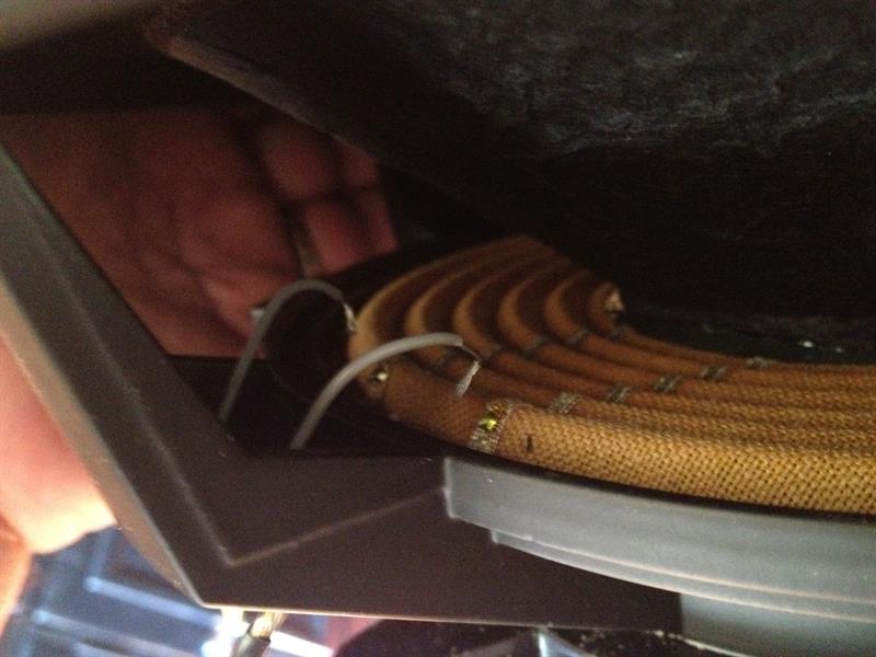

PMAT 2,067 Posted May 9, 2014 Author Posted May 9, 2014 It weighs about 90 lbs. The amp is heavier than the original. I did not modify anything on the drivers. I just soldered the tinsel leads back on the spider. You can see from the one photo that the leads are woven in the spider fabric. The original owner was playing it at max volume during a party and the amp had a catastrophic failure of some sort and melted the leads. It must of went up in smoke literally. The rest of the driver was fine. It is a seriously over-built motor. I also got the amp off Craigslist for $80 from a contractor that had removed it from an infinite baffle in-wall home theater setup driving two 15 inch MCM pro drivers. 1

PMAT 2,067 Posted May 9, 2014 Author Posted May 9, 2014 I am also curious about the driver configuration.....did you do rebuilds, or replacements, and did you try to get close to the original specs (not that it matters that much with a sealed enclosure...)? And did you wire it opposing (push/pull)? Very nice work by the way...... Edit: Ok. We must have been on the same wavelength for a minute The drivers are not set up push/pull. I called Legacy specifically for that reason. They are very nice there. The tech had a couple of used drivers there but no replacement amps. I could not match either so I repaired the drivers and replaced the amp with a higher current rated amp. The used amp was on MCM's website and I was able to spec it. Then a week later it was removed from the site. I got lucky there. 1
