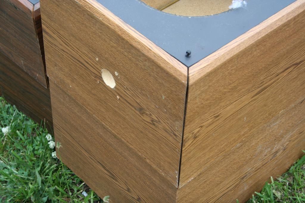

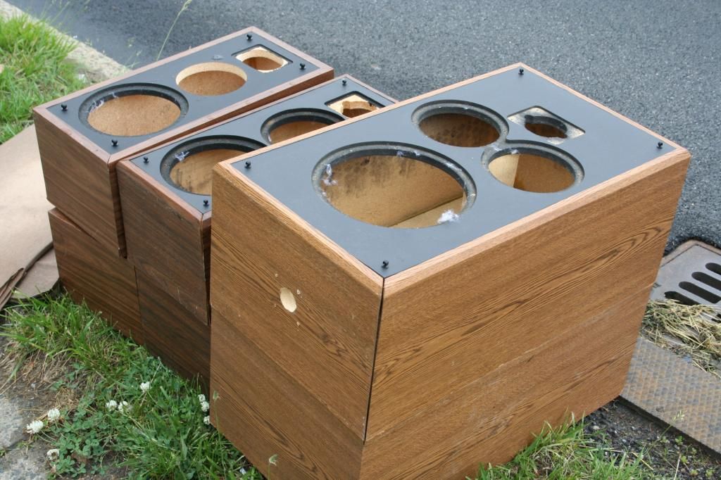

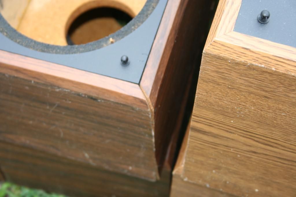

kve777 6,897 Posted June 9, 2014 Posted June 9, 2014 Here are the donor carcasses, kicked to the curb- trash day tomorrow. Monitor 10's, Monitor 5's, Monitor 5A's. Water damaged cabinets.See the cracks at the corners? Yeah, too bad. Oh, somebody put pole mounts in the 10's.
Schurkey 139 Posted June 10, 2014 Posted June 10, 2014 I suppose it's too late to save all the grille retainers.
kve777 6,897 Posted June 10, 2014 Posted June 10, 2014 I suppose it's too late to save all the grille retainers. I tried, they did not want to come out. Any time I come across broken ones I use Velcro squares, stapled in place. How many do you want? I'll try in the morning...trash day is Wednesday, I put them out a day early. Lost track of the days. See my apology post.
