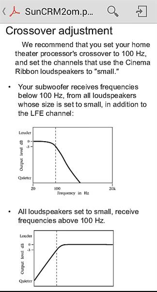

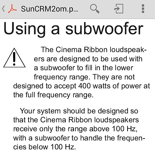

fill35U 1,850 Posted April 16, 2015 Posted April 16, 2015 Personally I would run the sub off of the pre-outs. (snip)...Then just wire the CRM-2's straight from the A speaker jacks. But that doesn't protect the CRM-2's from being overdriven at low frequency?: Or is that not an issue, since the 900 will audibly clip before thermal or excursion limits of the CRM-2's? Seems like a substantial tradeoff in headroom if you don't use *some* kind of crossover. Maybe also try line-level passive crossovers in the pre-outs loop(after splitting off the sub's signal!) for cheap comparison? At least you'd have more control. 1

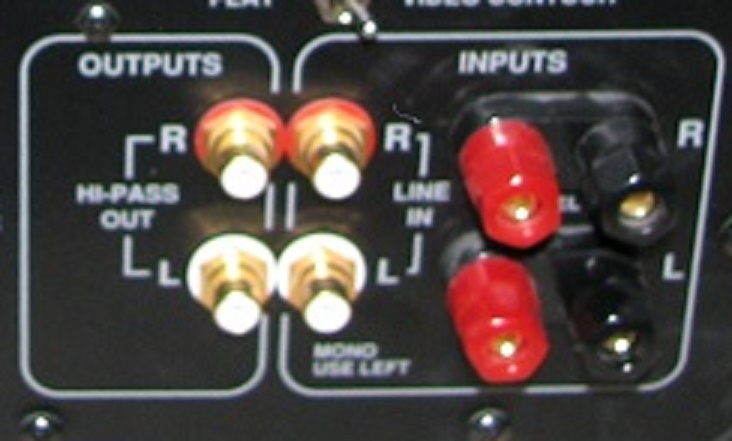

SteveMKentucky 70 Posted April 16, 2015 Author Posted April 16, 2015 (...) Or is that not an issue, since the 900 will audibly clip before thermal or excursion limits of the CRM-2's? Seems like a substantial tradeoff in headroom if you don't use *some* kind of crossover. Maybe also try line-level passive crossovers in the pre-outs loop(after splitting off the sub's signal!) for cheap comparison? At least you'd have more control. It does seem to make sense to have some sort of crossover in line between the receiver outputs and the speakers. That's the main reason I originally connected the sub between the receiver and the CRM-2's. I expected that the crossover within the sub would perform that function. I guess the question is whether or not I need a higher quality crossover to take full advantage of these speakers or not. By the way, the Sunfire sub contains such a crossover. Correct?

LVMAN777 408 Posted May 13, 2015 Posted May 13, 2015 "..The Sunfire subwoofer contains such a crossover. Correct?..." A crossover for "line level" inputs and outputs... Not for a power amplifier...
