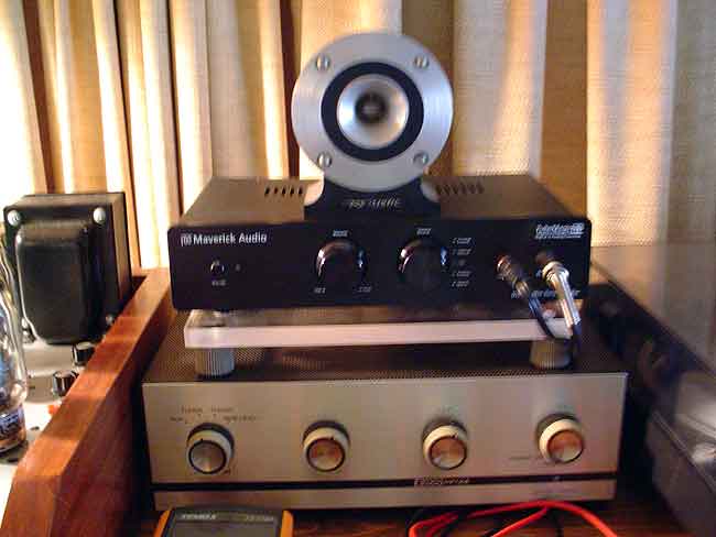

sKiZo 186 Posted November 8, 2015 Posted November 8, 2015 Huh ... what's the time limit on edits? I was gonna add a pic of my stack on a prior post, but ... ah well. Hey, I got a pic to add to a prior post! I mentioned putting a piece of acrylic between a mono amp and my Maverick tube DAC ... As you can see, it's quite a massive piece of acrylic, left over from another project. I used some old knobs for legs underneath to get some airspace. The Eico is perforated all around with an open back, so no worries there. The top of the acrylic gets somewhat warm during use, but very little heat is transferred to the DAC, so I call it a win. And ya, it's kinda tight on the sides of the Eico as well, but we works with what we gots. Also no major heating of the wood on the main amp or the table. Oh. Sorry bout the shaky pic ... one too many cups of coffee today .... <G> 2
