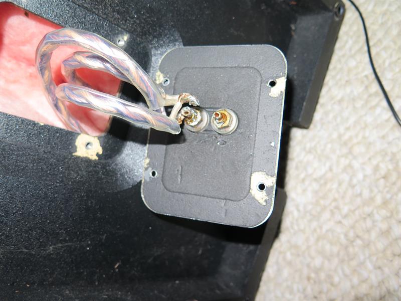

wrf 5,340 Posted February 3, 2016 Posted February 3, 2016 I recently managed to destroy three (out of six) drivers in my Thiel 3.6 speakers. Lets just say that a system installed in a back room, powered by a mk II and controlled by a Logitech RF remote is an accident waiting to happen when listening from the other end of the house. Turns out I destroyed both mid ranges and one tweeter. I pulled one of the mid range drivers and nearly passed out. The solder joints looked like they were done by a three year old. Looking closely, you could see where the speaker was previously wired with solid core wire - now clipped off. In its place was some funky stranded wire poorly soldered to the speaker lugs. WTF??? I opened up the other mid range and found the same thing. I opened up all the drivers. Somebody had completely rewired both speakers with that funky stranded wire. Funky because there was some kind of plastic core that the strands wrapped around. That made stripping and soldering a challenge to the three year old that did the work. Same bad joints on the crossovers. One connection on the binding posts broke upon disassembly. Good grief. I checked the Thiel web page. Got some kind of strange temporary page saying they were making changes. Uh Oh. Called the phone number. No announcement that you have reached Thiel. Just some nice piano music and a beep to leave a message. Oh No!! I left a message. Within a couple of hours I got a phone call. Ultimately I talked with a gentleman named Rob in Kentucky. Rob listened to my story. Expressed shock at the rewiring and patiently walked me through all the things I should check Resistance values at various points on the crossover. How to get the crossovers out of the cabinet. How to get the wiring out of the cabinet. What the wiring should look like. Even told me what damage to look for in the cross overs - and they WERE damaged. All this off the top of his head. Bottom line is that Rob is rebuilding the drivers (replacements not available). He is also providing new wiring, binding posts and ID plates. He helped me compile a parts list to repair the crossovers and provided instructions on how to mount some of the parts to avoid future damage. He is even sending some silver solder to use in reassembly and some drawings to make sure I don't screw up the wiring. All the parts are drawn from left over Thiel stock. WOW. Turns out Rob was the Director of Manufacturing at Thiel. I was telling him how nice the cabinets looked inside. He then explained to me EXACTLY how they manufactured them - right down to some of the angles they used on the CNC machine to make sure the glue flowed correctly. He figures he probably made my speakers! There is a box of drivers and parts on its way to me from Kentucky right now. It will keep me out of trouble for several days. It wasn't cheap. It's not a cheap world. In fact it cost quite a bit more that the speakers will be worth - especially considering what I paid for them. But they were without question the best speakers I've had. Hats off to Rob and Thiel Audio. Thiel is going through some tough transitions. It's not easy making a buck in high end any more. Best of luck to Thiel and a big Thank You to Rob. A few photos below. 2

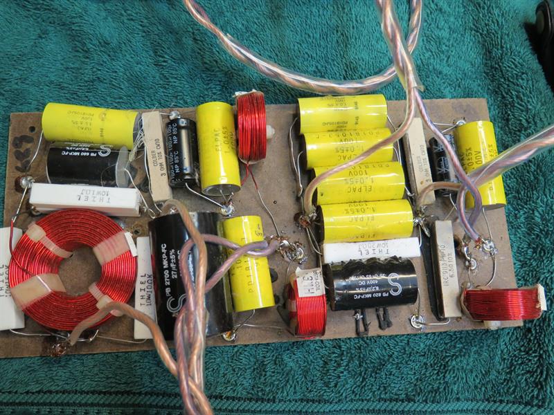

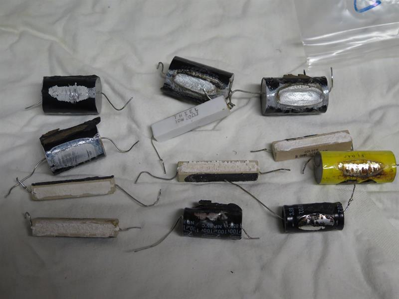

wrf 5,340 Posted June 13, 2016 Author Posted June 13, 2016 Followup. I finished up the Thiel 3.6s a while back. Rob at Thiel rebuilt the drivers and sent me enough parts to rebuild the crossovers. He also sent some official Thiel wire the replace the funky stranded stuff. New ID plates and binding posts were also on the menu. They sound fantastic. But.... a couple weeks ago one of the rebuilt mid range drivers failed. IT WASN'T ME!! I have been babying these guys because of the stupid amount of money and work I put into them. I contacted Rob and sent it back to the Thiel mother ship. The driver had a weak joint where a wire had broken. Rob fixed it for free and had it back to me within a week. Here's a photo of all the failed cross over components. Some of the ceramic resistors were open. In addition to the failed and fried components, I replaced all the electrolytic caps. Following Rob's advise I also arranged the components on the cross over to avoid caps leaning on hot resistors. 4
