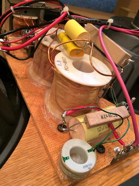

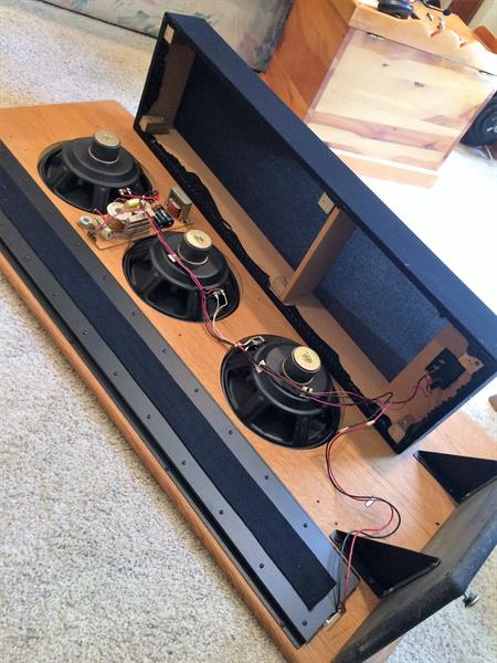

aslan7 956 Posted June 28, 2016 Posted June 28, 2016 Every so often I blow the factory fuse for my left side AL Silver when listening to them quite loudly. Purchased in 1990 and redone around 2003. I'm currently running an A500x mono bridged to the left as well as another one to the right speaker. Switched amps and problem still persists occasionally on that left speaker. I had some time today to disassemble the back and check out the guts. All looks normal but I took pics to post since the experts may see something out of wack. It's not a big deal and only happens when I drive them hard but I am a perfectionist with my equipment. Just don't know why the left side speaker fuse blows and the right does not. Any help or ideas would be appreciated since my Financial Planning degree does not do much good in troubleshooting electronics. Thank you tech's! 5

RodH 4,868 Posted June 28, 2016 Posted June 28, 2016 Take a look at where the enameled wires cross over each other or over bare wires. Is there a spot where 2 might touch & short with vibration?
fill35U 1,850 Posted June 28, 2016 Posted June 28, 2016 Take a look at where the enameled wires cross over each other or over bare wires. Is there a spot where 2 might touch & short with vibration? Those Silvers XO's are a mess of spaghetti! Maybe start looking hard in this area: Rearrange all the wires, until there's at least 1/2" between each one. Then play loud and see if the fuse still blows. You might have to do actual troubleshooting if that doesn't work. Run the ribbons and tweeteers each alone, then focus on which section still blows the fuse. And I guess today is a good day to start a thread on my Silvers, too! 3

aslan7 956 Posted June 29, 2016 Author Posted June 29, 2016 Btw What is the purpose of just those bare copper wires? Is there a Crossover 101 explanation for that pic of wires?
zumbini 6,154 Posted June 29, 2016 Posted June 29, 2016 What is the purpose of just those bare copper wires? They are not bare, they are coated with enamel which acts as insulation. Note: It's best if the coil wires don't touch each other or anything hard or sharp so vibration doesn't wear the coating off and cause a short. 5
aslan7 956 Posted June 29, 2016 Author Posted June 29, 2016 What is the purpose of just those bare copper wires? They are not bare, they are coated with enamel which acts as insulation. Note: It's best if the coil wires don't touch each other or anything hard or sharp so vibration doesn't wear the coating off and cause a short. Wow. Did not know they were coated. With how meticulous Carver products seem to be on the inside, I'm surprised those wires are all over the place. I'm going to try and make sure they stay separated from each other and a little more organized. Thanks Z!
zumbini 6,154 Posted June 29, 2016 Posted June 29, 2016 ....With how meticulous Carver products seem to be on the inside, I'm surprised those wires are all over the place. I'm going to try and make sure they stay separated from each other and a little more organized.... Neatness counts visually but messy wiring rarely affects the performance of the crossover. OTOH inductors can interact with each other electrically so their location and orientation is important. To avoid this place the inductors on opposite sides of the board and orient them at 90o angles relative to each other. 3
danowood 2,167 Posted June 29, 2016 Posted June 29, 2016 I like to add shrink tubing to areas that can possibly make contact with other wires or metal caps in the event of the enamel coating being breached. While I had it apart I would either upgrade or replace the caps IMO. 1
fill35U 1,850 Posted June 29, 2016 Posted June 29, 2016 With #7, make sure the coil centerlines are perfectly aligned and will stay there. If they're offset by a fraction of an inch, you could give up 20-30dB of isolation. Also keep the coils away from other metal, especially ferrous (screws, baskets, magnets, fuses). No point in wasting power and causing distortion by using your amp as an induction heater... None of the above should be an issue with inductors that have closed-path cores, but then you have to be sure they're big enough/gapped right/use good enough materials that they don't saturate. 1
aslan7 956 Posted June 29, 2016 Author Posted June 29, 2016 ....With how meticulous Carver products seem to be on the inside, I'm surprised those wires are all over the place. I'm going to try and make sure they stay separated from each other and a little more organized.... Neatness counts visually but messy wiring rarely affects the performance of the crossover. OTOH inductors can interact with each other electrically so their location and orientation is important. To avoid this place the inductors on opposite sides of the board and orient them at 90o angles relative to each other. Well when I look at my pictures, it appears to me like my coils are situated at the #3 postition in your picture Z--ie BAD. They are covered with what looks to be a hot glue type of substance so I do not think they are interacting with each other negatively. In any event, I did tidy some wiring up as per Rod's post making sure the copper wires were all about 1/2" from each other. Closed everything up and tested. Linkin Park's "Somewhere I belong" was played at ear splitting levels and the fuse passed the test as well as Rush's "Red Barchetta". Unfortunately about 3/4 the way thru Bohemian Rhapsody the slo-blo 3.2a fuse blew. . Replaced it and all is well for now--until I want to wake the neighbors. Thank you all for your suggestions. Just have to watch the volume level for now.
