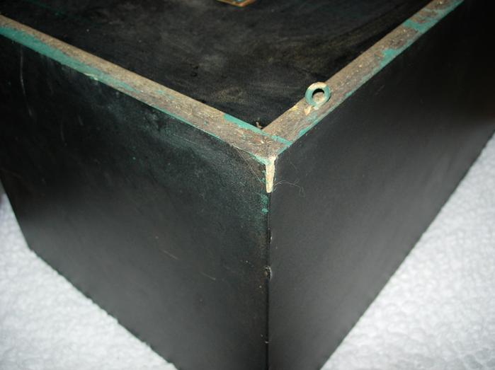

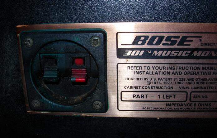

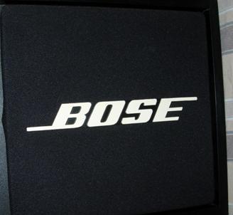

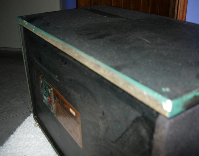

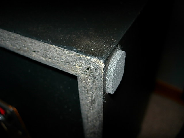

Guest David Posted May 7, 2010 Posted May 7, 2010 Hello! *Please if the moderator believes that this post is in the wrong place you move. Recently I comment that I would repair a BOSE 301 Monitor Series 2, which I had gotten. A friend in a restaurant had abandoned speakers for years. I asked him to sell them but he said he chose two of the four he had. I chose those with the drivers in perfect condition, he and gave them to me. The speakers have the corners damaged, rusty screws, smell of food and has been painted the same color as the walls ..... The idea is to leave them outside in an acceptable state, without spending much money. The sound is typically BOSE-with all the good and bad. For me it is more a sentimental memory for the sound aspect. In the pictures that they had put a general cleaning. The car I had to leave with the trunk open one day to remove the smell of food .... When completed I will put more pictures. Thanks for this wonderful forum.

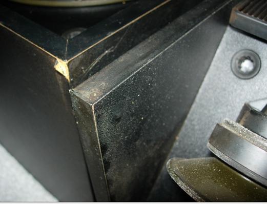

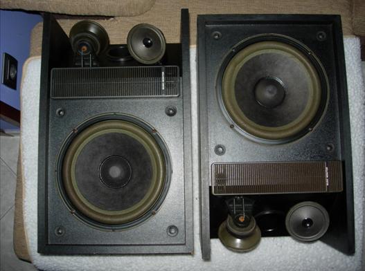

Guest David Posted May 10, 2010 Posted May 10, 2010 Hello again! I leave you more pictures. As it stands now could be put in the living room. The "wood" (if you can call it that) comes back the original shine. I need to improve some corner and remove some remnants of green paint (look pictures). Later I will take the speakers to see inside. The money spent between speakers and material has already reached € 10 -need more for a Hollywood blockbuster, but I'm happy ..... When I finished I would put more pictures. Greetings and thanks for the forum.
zumbini 6,153 Posted May 10, 2010 Posted May 10, 2010 Looking good David! Certainly a big improvement over your before photos. By the way, your cabinets are made from MDF (Medium Density Fiberboard). (At least that's what we call here in the states. I think across the pond they call it engineered wood.) It's chunks of wood bound together with adhesive, and formed into sheets under pressure. The result is very dense which is good for absorbing vibrations. Not so good for pretty exteriors. It's general covered with some kind of laminate to dress it up.
Guest David Posted May 10, 2010 Posted May 10, 2010 Exactly Zumbini, you can see in the open corners of the speakers that the material is MDF. Here in Spain is called the same (MDF) or in spanish "Tablero de DM" (Medium density board) By the way -when done- if still smelling of food, I have to put them in a plastic bag for a week with an air freshener ....

kve777 6,906 Posted May 10, 2010 Posted May 10, 2010 Just a few ideas...I've used Febreze to get odors off of equipment, quite successfully... Also, I have filled damaged wood/MDF with Polyester Body Filler(Bondo), sanded smooth, then recovered cabinets with new vinyl. Can get it in many colors and textures. Not too expensive. Krylon Fusion spray paint also works well on speaker cabinets, clean with paint thinner first helps adhesion. Good luck with your project! 1
