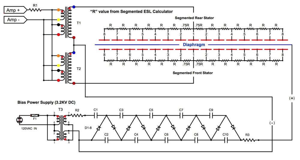

jazzman53 1,302 Posted February 19, 2021 Posted February 19, 2021 (edited) I know just enough about electronics to get myself in trouble, but not enough to fix anything -- and I need some help diagnosing a problem with one of my newly built Jazzman MkIII electrostatic speakers. I was burning it in, and after about 2 hours playing, I started hearing a low level static, which sounds something like radio static. I've never had this problem with any of my prior speaker builds. My schematic is posted below. I swapped out the electronics interface (HV bias supply & step-up transformer package) from one of my other speakers, and the problem went away. So; the problem has to be within the bias supply or step-up transformers. I checked the diodes for one-way conduction and found no faults. I don't have an ESR meter, and I understand that capacitors should be checked out of circuit with a DVM. I didn't want to pull those ceramics out of the board because I cut the leads so short, but as best as I could tell checking them in circuit with a DVM; I'm not seeing anything wrong there. What I don't know how to check are the small transformer feeding the bias supply, and the toroidal step up transformers. Note that the bias supply has a floating ground connecting to the center tap between the step up transformers. Aside from the low level static, the speaker plays normally with no distortion, so I'm thinking the step up transformers should be OK (?). The 115V AC input to the bias supply is switched with the amps. And when I turn the amps on; I immediately hear static emanating from the ESL panel. Then; a few seconds later the relays in the amps switch on, bringing the amps into the circuit, and the static decreases but doesn't go away. I've ordered the parts to replace the entire HV bias supply, including the PC board. If that doesn't fix the problem, then it has to be within one of the step-up transformers, and I would then replace both transformers. The step up transformers I have to order from Europe-- they aren't cheap and it takes several weeks to get them. Anyone got any ideas what's causing the static? Edited February 19, 2021 by jazzman53 1

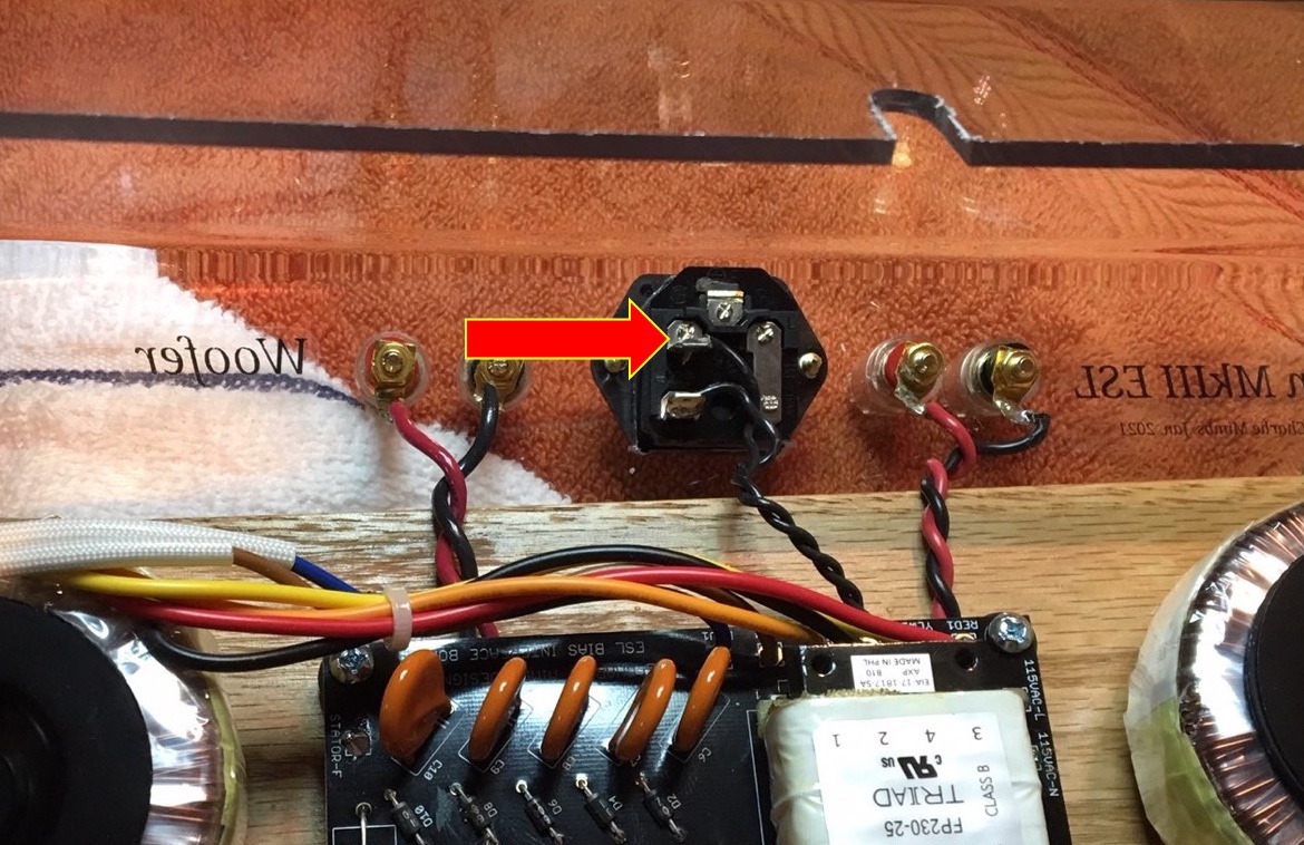

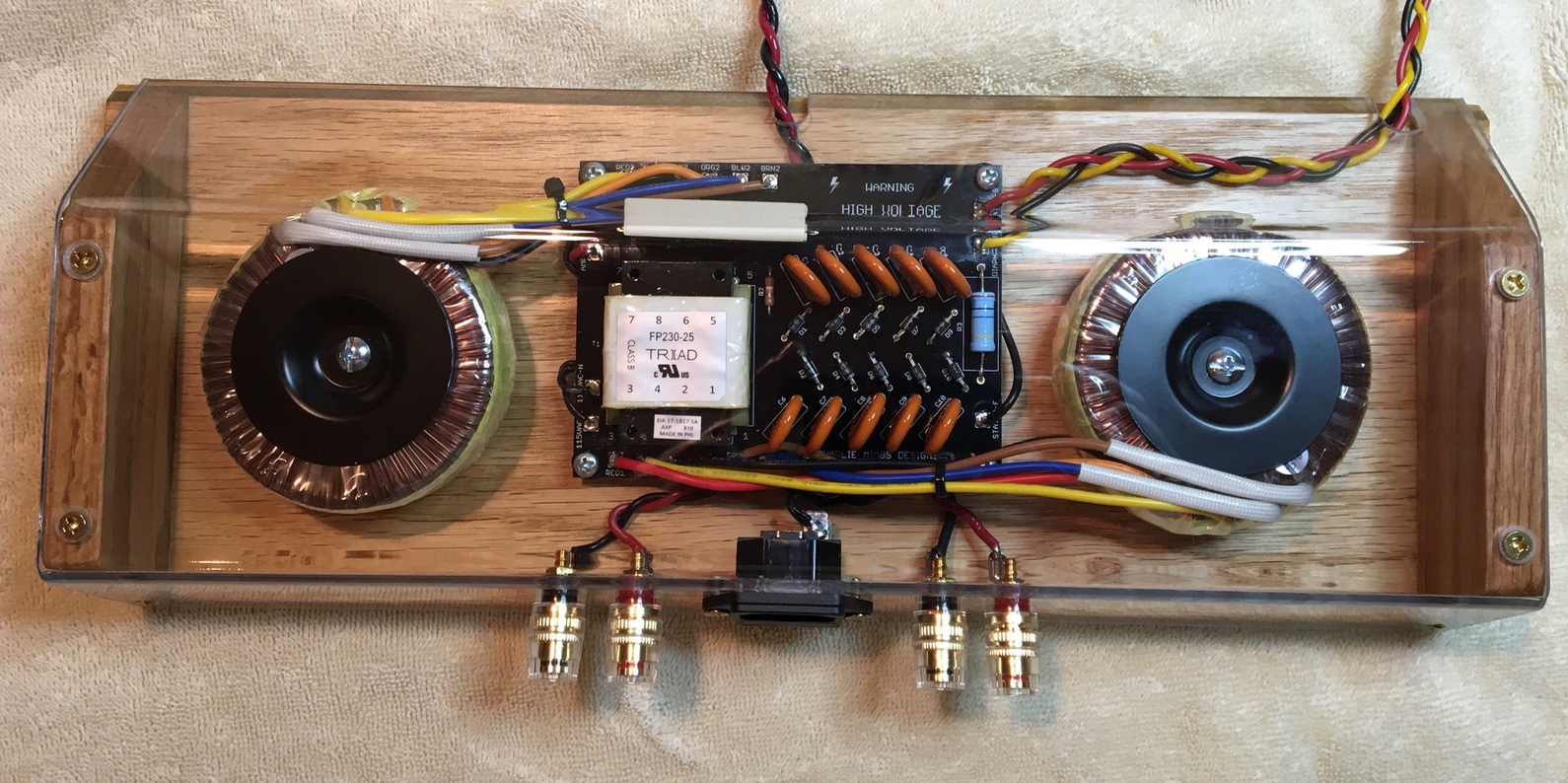

jazzman53 1,302 Posted February 26, 2021 Author Posted February 26, 2021 (edited) Static problem is resolved: This afternoon a received the parts from Mouser, and built a new bias supply on a new PC board, for the problem speaker. While I was installing the new bias supply, I found the REAL source of the static-- something I had completely overlooked, and it wasn't in the bias supply, but the connection from the AC receptacle to the bias supply. When I soldered that connection, I couldn't see it straight on, and had to solder it from an oblique angle. It's easy to see now; thru the plexiglass cover, but when I soldered it; I had not yet peeled off the protective backing from the plexiglass. The wire is merely inserted thru the hole in the connector -- the solder bead didn't even wet it --- have a look below. The second photo is looking thru the plexiglass cover. I'm feeling like an idiot for the screwup but I now have a spare bias supply if I ever need one (not likely because I've never had one fail in 13 years building ESL's) I have the speakers playing a Vanessa Fernandez album while I'm writing this, and it's sounding fabulous. Both pairs turned out really nice. Edited February 26, 2021 by jazzman53 2 4
