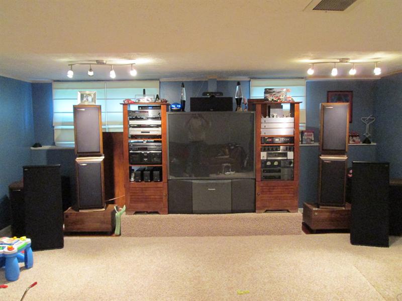

Zoom 373 Posted June 27, 2014 Posted June 27, 2014 I've owned a pair of DCM-TF350s since the early 90's. Probably my second set of nice speakers I've ever owned. I still have them. Vifa drivers with rubber surrounds. Maintenance free and nice, tight, and clear with transmission line ports for even bass extension. So,about 2001, when offered a chance at a set of TF-600s, the bigger brother, I jumped. They have a pair of front firing Vifas, and three tweeters, 2 time-aligned diagonally to the rear/side and one forward. I got them home, set them up in a shitty sloped roof room, with lots of interference, and they sounded like shit. I couldn't figure them out. I was severely disappointed. Until I moved. They went first. Into an empty room, fed by an old JVC personal disc player, earphone to rca input to a ... a PM-1200 I hadn't even used yet, but knew I needed a couple for the new to me concrete floor. So, JVC personal disc player input to PM-1200 output to a pair of DCM TF -600s. All alone in a room. They ROCKED. filled the whole damn room. Sounded excellent. Unbelieveable. They are currently my best set of fronts for critical listening, fed by my M-500t. So, my question is, For the rear-firing equipped speaker, and for any dipole/flat panel, infinite baffle, how important is 'Rear-field' contamination, and how should it be set up? Are there requirements with new dipoles for rear reflection surfaces? Any proof? Along with my DCMs, and many others, the RS-IIs Bean is picking up have rear firing drivers. This question came to me especially hard after I read the thread with the link from Phil about the designs of the Dahlquists. And how the engineer talked about resonance from instruments going 360 degrees. I thought, 'Wow, he's right' But if you are trying to throw an audio signal rearward to simulate rear ward resonance, what happens to that rear signal if there is rig in the way? Makes ya wanna go hmmmmmmmm 1
Bean 384 Posted June 28, 2014 Posted June 28, 2014 Ideally there shouldn't be anything between the speakers.... notice the quotes around ideally. This is true for most stereo speakers such as Carver AL-III's, Magnepans, etc.... But ideally and reality dont always meet... So keeping as much stuff out of the way as you can is good. Or pull the speakers out where they are NOT flush with the system if possible. I honestly am not sure how I am going to set mine up just yet. I have a "plan" but until I get them in the room I wont really know. I am hoping I can minimize things keeping my gear a bit behind the speakers but again not 100% sure... I think in my case as long as I can keep the gear at or below the height of the rear firing tweeter I will still get a large part of that wrap around effect... Ideally I would break into the closet behind my setup and build an enclosure that comes into the room but is flush with the wall. I may still do that eventually lol...... I also need to investigate the linen closet in the bathroom thats behind that wall to see where it falls. If I can take some of that for a rack, I probably will but again I wont know w/o drilling a tiny little hole lol.... while my wife isnt around 2

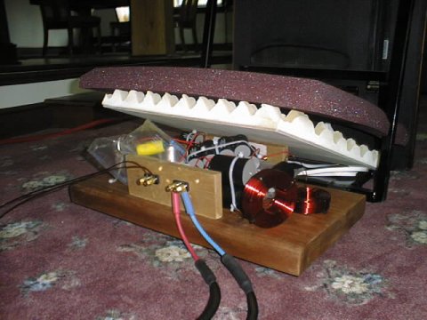

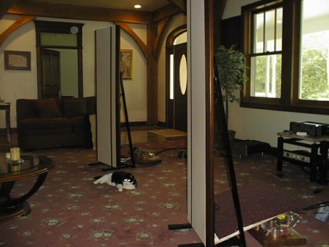

dazed_and_confused 194 Posted June 28, 2014 Posted June 28, 2014 Very chic and stylish, and you won't have to shell out too much... In every room where I've had dipoles I've always found that leaving the front wall untreated and having the speakers well out into the room, sounds better than having any sort of random treatments on the wall. I went to the time and expense of making a bunch of treatment panels from acoustic foam, attaching 2x2 foam panels to 1/4" plyboard, and I always preferred the sound without the panels on the front wall. You can see one of the panels in the picture below. I used them to deflect/absorb sound away from a custom crossover I made for my old Maggie 3.6's....... You can see it more clearly here....with Bandit the cat (RIP)......note the windows behind the speakers and the distance from the wall... The image below, borrowed from here http://www.linkwitzlab.com/rooms.htm is telling - you can see how the energy coming from the front and rear is equal with a dipole or open baffle design and how the sideways energy is significantly less. (Pertinent to Carver Amazing owners too, where the cone woofers are open baff and act as dipoles mostly) 1

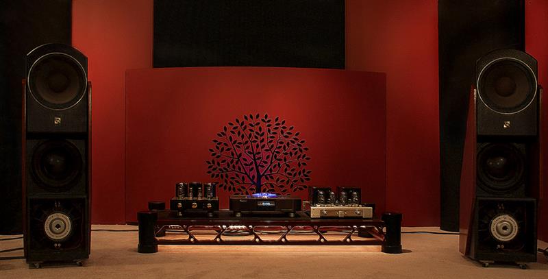

PDR 1,195 Posted June 28, 2014 Posted June 28, 2014 The difference, for me in my room, with the QRD is something I'll not go without with the open baffles I own. I was lucky in the fact that I started with a empty dedicated room.... It made my system sound like a piece of crap. I barely listened in there till the treatments went up. Started with a few, just to see..... Then added more, including the poly and the ceiling absorption along with the bass traps.... The QRD just brought depth and width to the soundstage I didnt have before..... But heres the thing.....when I place my arrays in the room......its not quite right, something sounds off. I'm guessing the QRD would do much better on the back wall, than the front with these..... Although when I use my GR speaks for the low end...dipole subs...it gets better I like what the diffusion does with the open baffles. I think if your curious the temp poly might give you an idea of what diffusion behind your fronts will do to your sound with dipole/bipole type.
dennismiller55 4,833 Posted June 28, 2014 Posted June 28, 2014 That is a great room Perry. I have always been impressed with your system and room treatments. I am sure I have seen each of the pictures in past post, but it is great to see them in one place from beginning to now.
trav0810 589 Posted June 28, 2014 Posted June 28, 2014 I would LOVE to be able to hear Perry's system. I have heard a lot of nice equipment, but never in a room that was specifically set up to optimize the system. Nice job Perry!

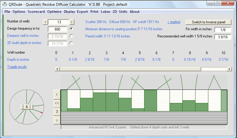

Community Admin AndrewJohn 11,616 Posted June 28, 2014 Community Admin Posted June 28, 2014 That is a very nice series to show the progression, Perry. My head was thinking how could I build something like this into my system..., and wondered if it was "guess" or calculated. Like a lot of things, some of this was over my head - so I pulled Google into service, and stumbled on this for a brief explanation of Quadratic Residue Diffusers (QRDs). This might be interesting from the QRDude on the Subwoofer Builder site HERE. And, the QRDude has a software package that seems to run on my WIN 7 system called the QRD Calculator, and shows a few design variations..., I haven't finished playing with it yet - need to do a thing or two today..., but wanted to share. Quadratic Residue Diffuser Calculator link HERE. It may be rudimentary, but an interesting read - 1
